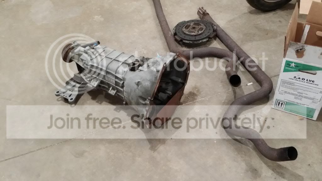

Back in had to do this twice because I forgot the spacer for the throwout bearing the first time.

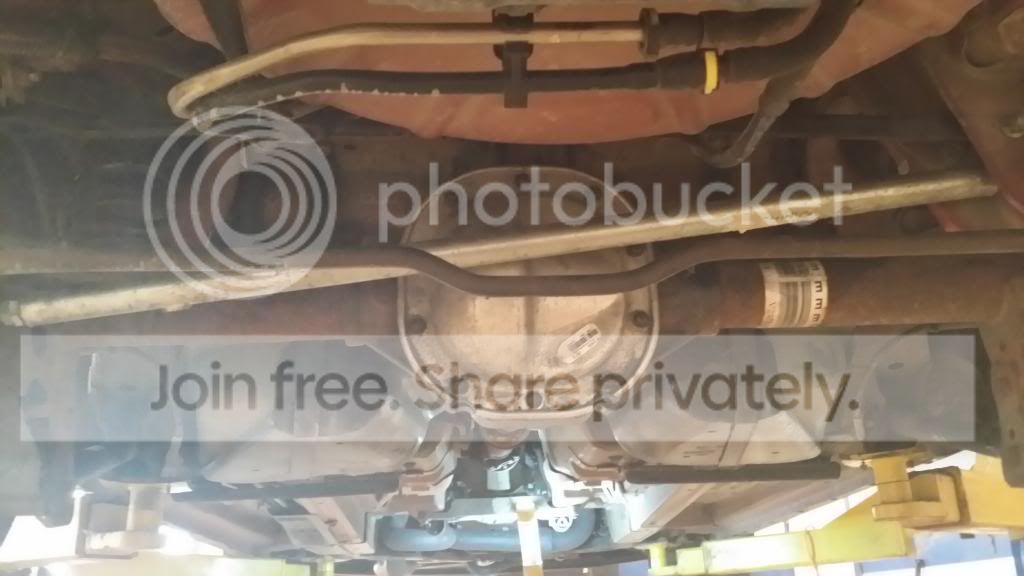

Removing the 4.10 FRPP gears and going back to the stock 3.55 gears now that it has a turbo.
