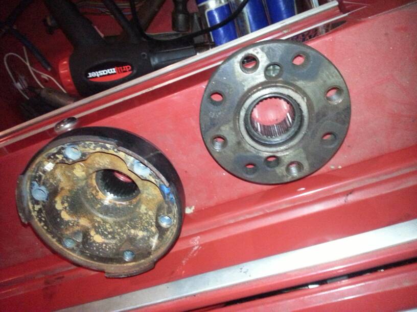

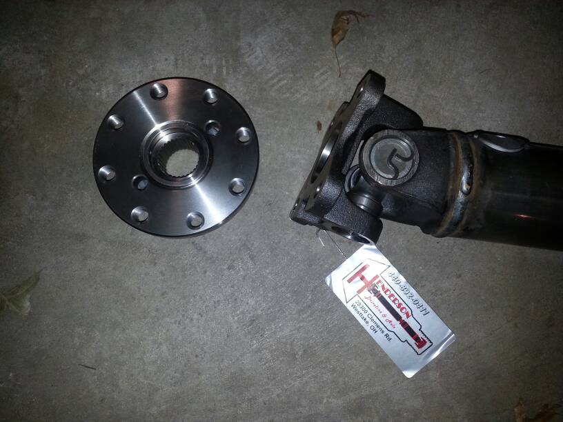

Changed the 2011 axle flange to a standard 4 bolt with a 1350 u joint. I took the measurement.

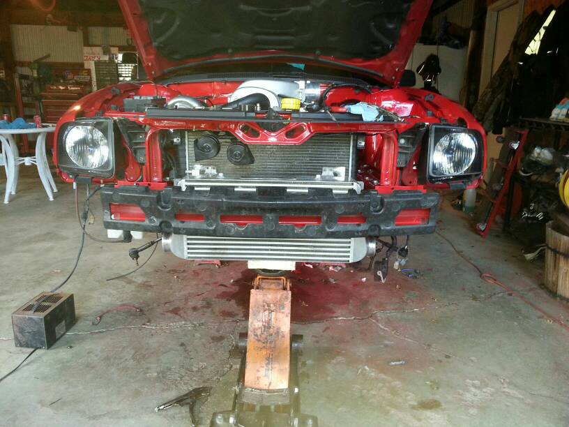

And finished front mount today.

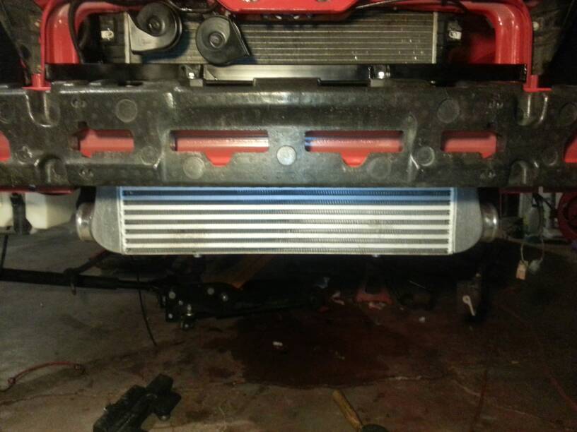

That IC mount is perfect. That's one of the few things I'm not overly thrilled with on my setup is how chincy the IC brackets are.
Dec 17, 2013
141
It's a good fit. Just some 1/1/4 box tubing with ends capped with nuts welded on inside of caps. Drilled through the sides of core support and bolted it in. I have little straps at bottom that tie into radiator plastic ac mounts to keep it from pivoting at bottom.

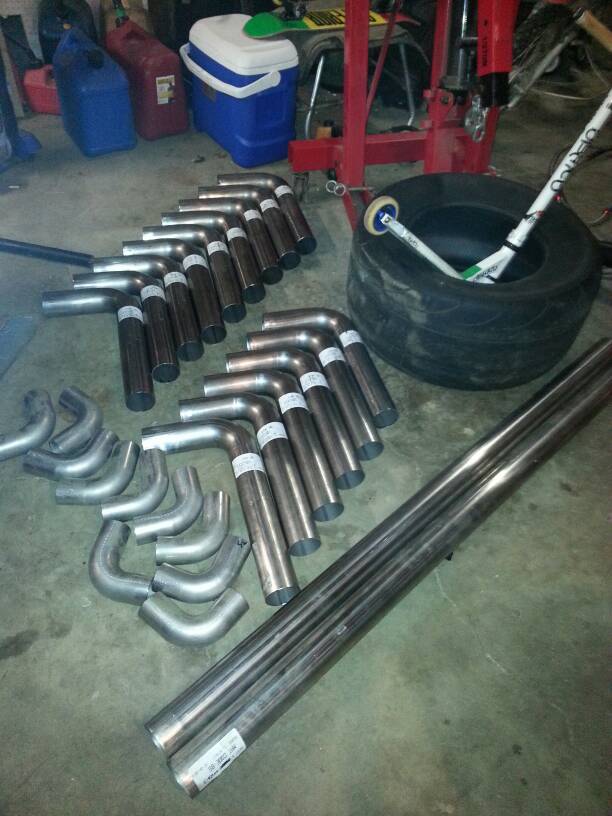

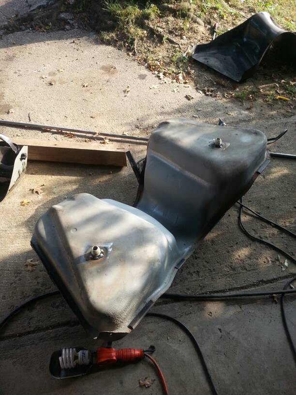

crossover 12 an and pickup for an lines. Gotta notch the tank for lines to run to bottom. Tight fit!!

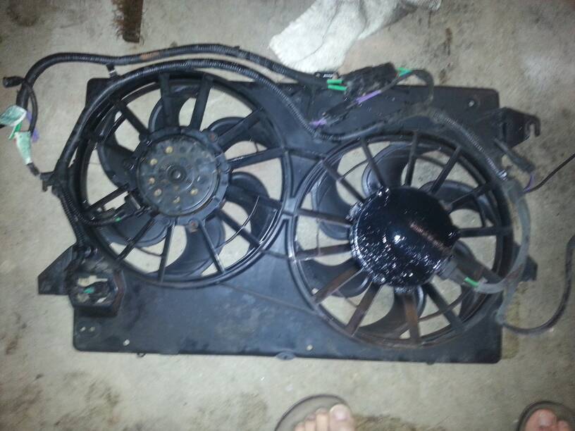

Budget was tighter after big purchases so a 400 dollar fan wasn't an option. I opted out and went to a local junkyard and pulled a 30 dollar 98 contour svt v6 2800 cfm fan. Alot of the fox guys are running em. Great flow!! I had one on my old fox but it went with the car.

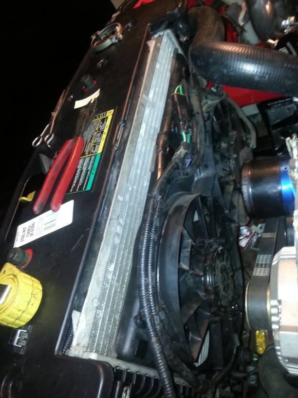

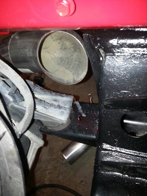

What a tight pain in the axx.
I can only imagine coldside on passenger side to be even worse since I'm keeping the windshield washer tank. Ugh!!

1350 u joint shat almost 53 inch long with billet slip yoke. I also upgraded the 8.8 flange to 4.5 inch bolt pattern.

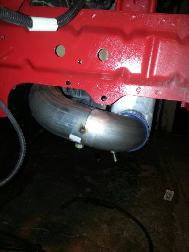

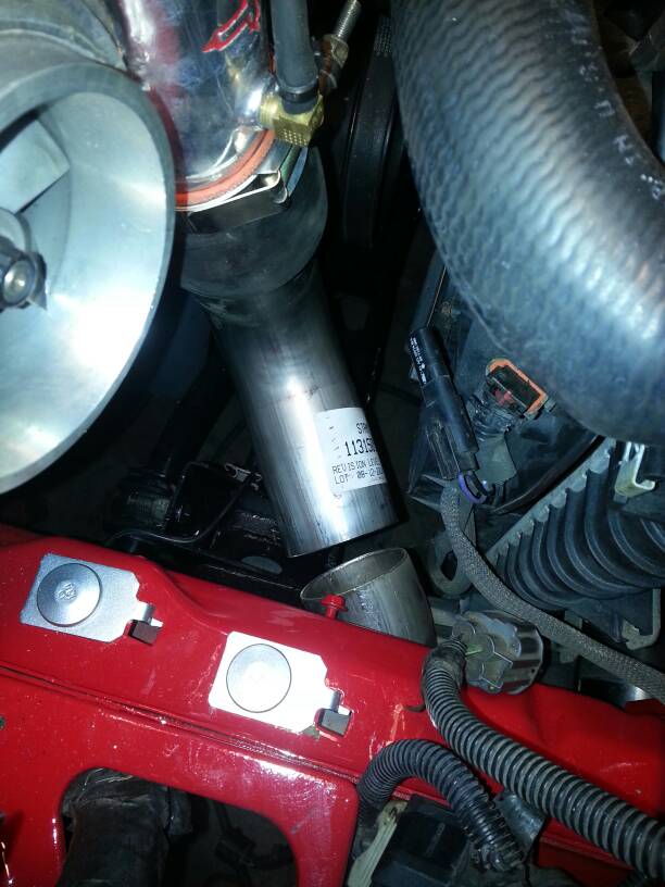

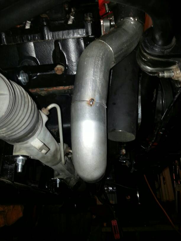

Now that pesky passenger side intercooler. Almost got her all tacked tonight.
A little piece and im golden. Couldn't get the angle I wanted. I'll make a piece out of cardboard and trace it on a pipe for cutting. Hopefully it comes out as one piece with no couplers. Then try out the new tig with practice. :eek:
