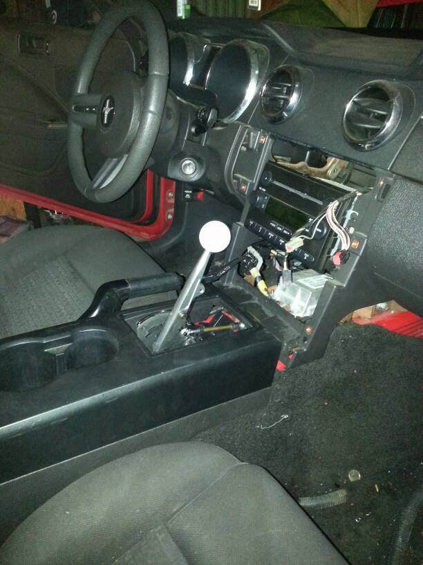

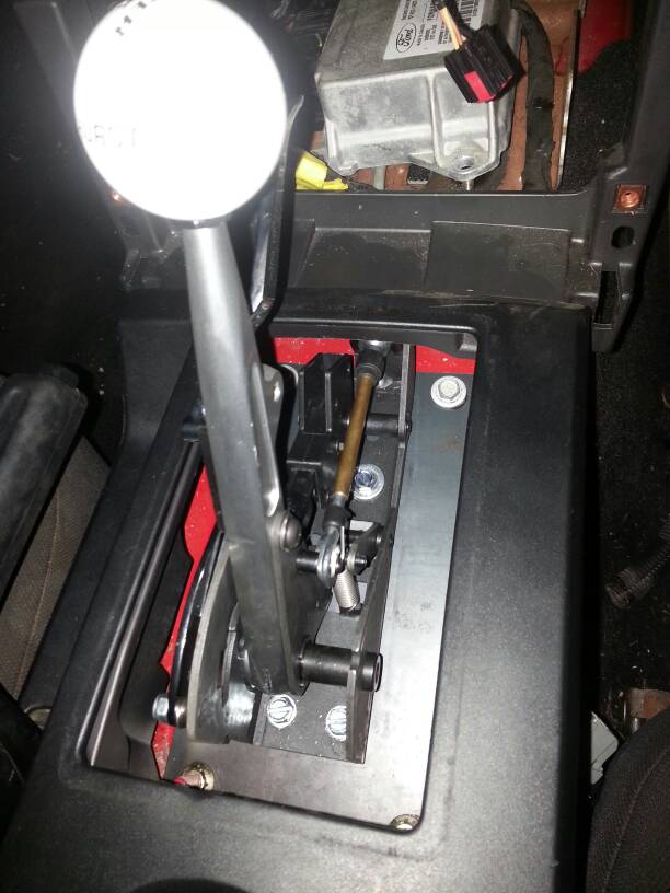

Quarter stick shifter mockup tomorrow. Stock shifter had plastic gates to modify with plastic roller. Not interested in reinventing the wheel. Moving on to fuel and finish wiring. Next year I'll focus on guages. All I need is a shift light.

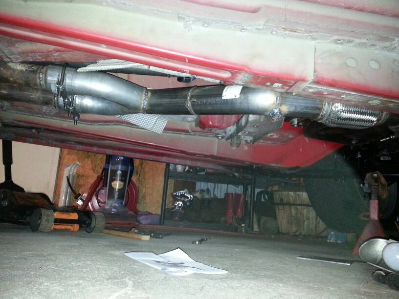

Looks good! One recommendation for the down pipe is not to do a forced split Y (capital Y) like you have, it creates turbulence and back pressure, do a lazy y (lowercase y) if you will. With that cutout open it wont really matter though lol

I agree that's optimal but in all reality I should run a straight through style muffler unlike the stock ones I mounted. That's where the open header comes in at the track. I just want a quiet car for the street. I hated how loud my old car was.
