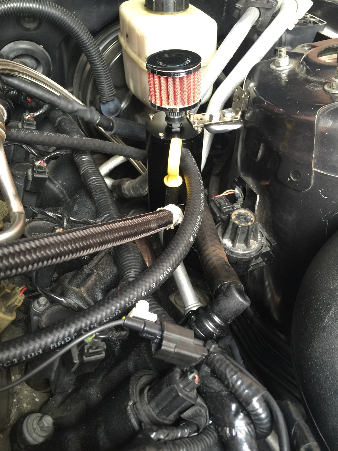

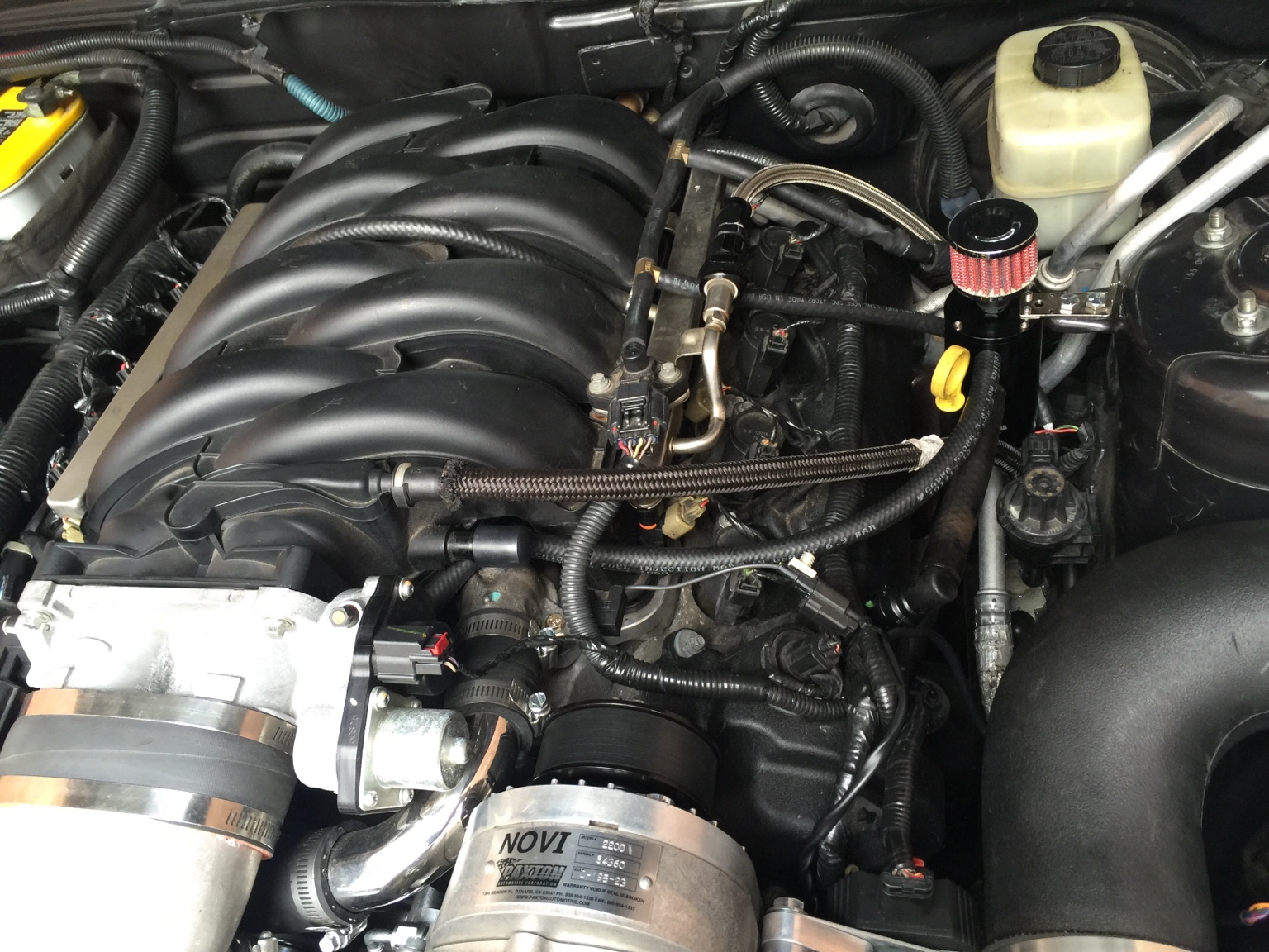

So I finally installed a breather filter and after the car warmed up and during idle I see excessive amount of smoke/vapors coming out of the filter. Looks like a vaporizer and smells like hot oil. Is this normal?

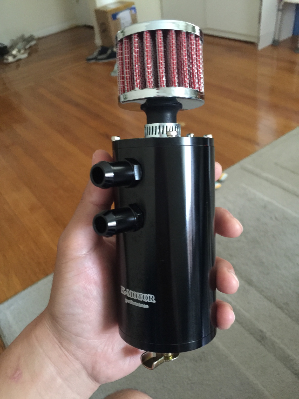

I actually have a breather tank.
Top nipple goes into the passenger side pcv and the driver side goes into the bottom nipple of the can.
There is a mesh filter between the top and bottom nipples.
Driver side manifold fitting is plugged and so the air intake.

Mine is capped as well, I just ran the hose of the passenger side under the throttle body so it looks like is connect but it's not.

Ok, so since the passenger side has more coming out should I be routing this to the bottom nipple of the catch can? Like I stated before there is a mesh filter between the top and bottom nipple.
Here's a video of the smoke:
