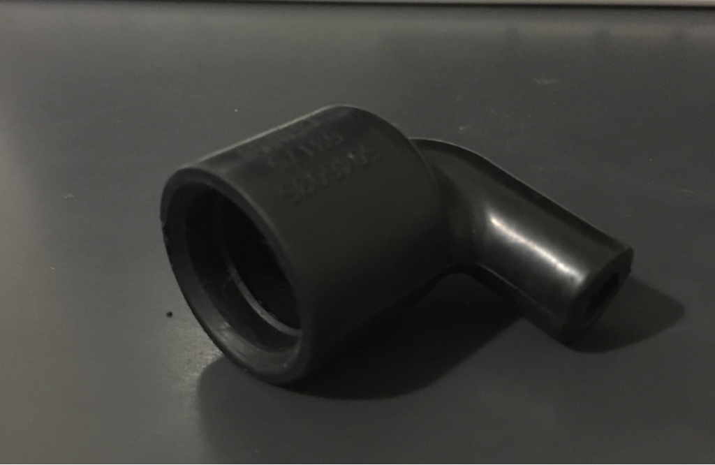

I decided to stop by autozone before coming home and found this:
It's a PCV elbow Dorman 47035 which will allow me to use the 1" port on the throttle body elbow on the Paxton and connect the passenger side pcv hose it.
I'll have to go back to a closed system until I finish modding the driver side cam cover for the pcv removal.
Once again, in order to run an open breather setup, you have to fully disable the factory PCV system altogether by capping off both the vacuum port to the intake manifold and throttle body air intake tube elbow..
By just capping off the PCV vacuum side and running a passenger side hose from the air intake elbow to the valve cover won't accomplish anything as once you cap off the vacuum port on the driver's side, the passenger side will no longer be able to pull in air without vacuum from the PCV system being open..
Until you finish modding for the PCV removal, just stick with the factory PCV closed system just the way it is and if I were you, I would follow Lito's advice when he says " Don't do that"
