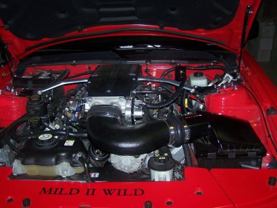

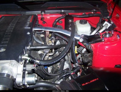

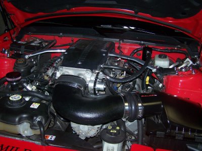

Images of Bob's oil separator as requested via PM..
There is no oil on the driver's side breather because there is no vacuum source opening the PCV baffle in the driver's side cam cover.
One catch can needs to go between the driver's side cam cover port and the intake manifold vacuum port. A second catch can should be used between the passenger side port and the intake tube if you want to keep oil away from the intake tracts.
Here's images of the Bob's oil separator as you requested.. I'm also still selling it if your interested ?
