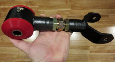

If you're lowered that much I'd say you need to adjust the pinion angle, and the only way I know to do that is with adjustable upper control arm. Some people do the adjustable lowers too. I haven't yet, but I have the BMR adjustable UCA and their mount. Beefy stuff.
