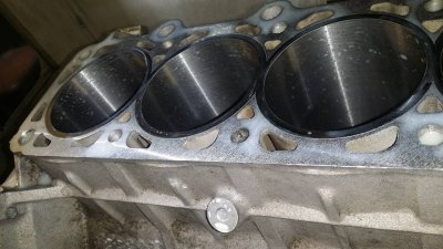

I'm planning a turbo build around a Turbonetics 7875, @20+, plus whatever spray it takes [likely 400hp worth] to trap 165+ to shutdown these stripped out grudge cars around here,, I'm tired of getting my ass kicked by em'.
The block has been sleeved with the Darton Coyote sleeves, the issue I'm having with it is the Cometic gasket was made for the iron Boss block and doesn't have the raised bosses around the water passages like the standard bore Cometic, the Coyote gasket also has the raised embossing so it seals .
I've talked to Cometic about getting a standard bore gasket cut out to 3.700" but they won't do it.
Soooo, the machine shop is pulling the sleeves, re-decking the block and going to reinstall the sleeve with .001" left above the block deck so that should allow the gasket to seal.
If that doesn't work I'll use a dremel and auger out a stock bore gasket myself. And if that still don't werk, we'll plug the passages and drill holes to match the gasket.
These Coyote sleeves will not move, they have a large lip that keeps them locked in place.
Cost was 950 for the sleeves, 750 to install.
Sleeves going in ..
Sorry for the thread jack .,.
Sleeves going in ..
Interesting, who is doing this machine work for you?
TKM Performance in Denton NC .
Kevin has sleeved a bunch of Coyote motors .. but mine was his 1st 4.6 and I did not realize the difference between the Cometic big bore gasket and the standard bore .
But now that we've seen it,, re-decking my sleeves should fix it.
