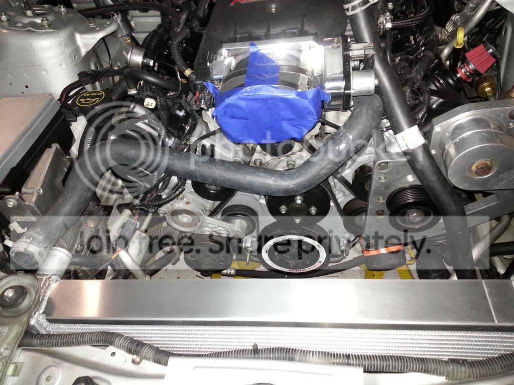

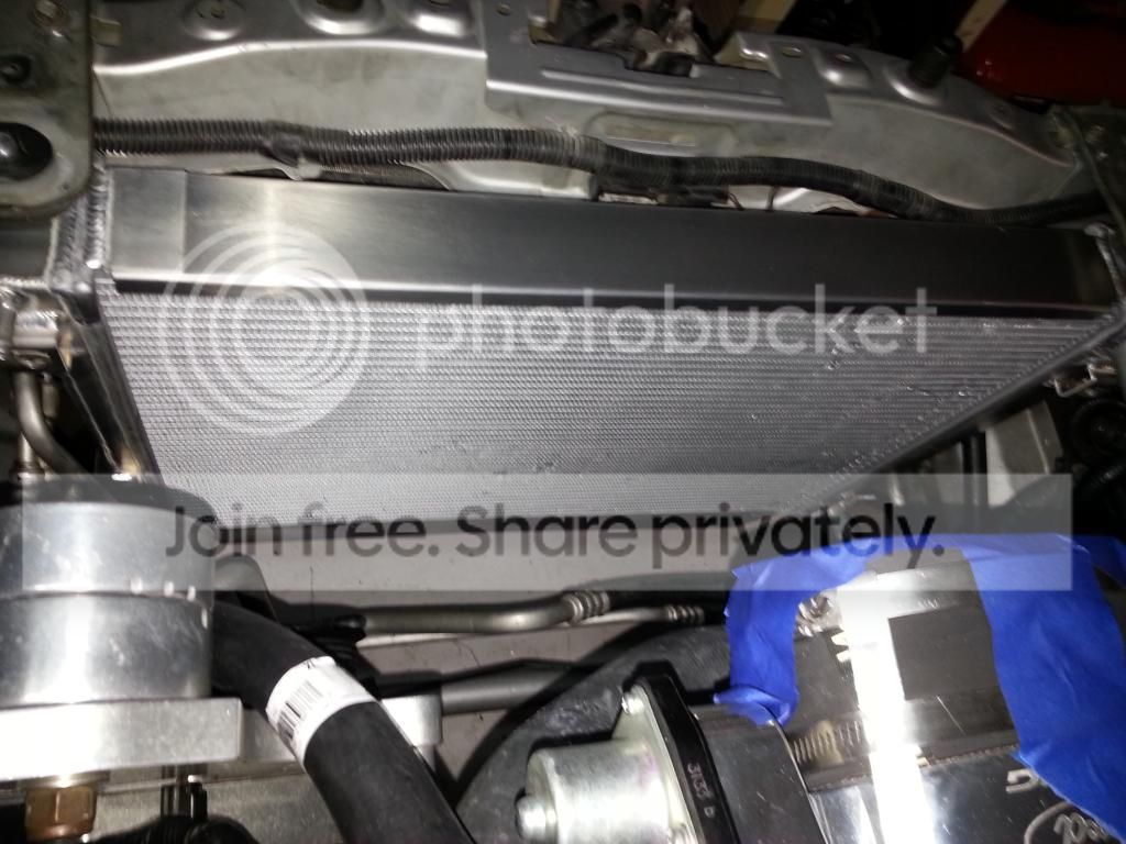

Still don't have my new SC!!! Supposedly will ship sometime this week. But did get some other things done while waiting including a new FRPP radiator and slim fan & shroud from Procharger to clear the new larger discharge pipes. The radiator was quite a PITA to install, I was surprised! I suppose if it was going onto an otherwise stock car it would probably be easier but I ran into all kinds of clearance issues since it pushed everything forward slightly which resulted in my IC being pushed into the back of the bumper, needless to say I spent a good amount of time cutting for clearance. All in all it came out good though.
Also decided to go with a 12 rib SC belt system and after the radiator install I only had about 3/4" clearance b/w the fan motor and 8 rib blower pulley so I remounted the new fan inside the shroud via 1.200" spacers, came out great and gained a ton of clearance! Still a mile of room b/w the fan and the radiator too.

Is this fan slimmer than the 2013 GT500 FRPP fan? I just installed one this time around, I've had it laying around the garage for over 1.5 years. I bought one as soon as they became available. Its quite a bit slimmer than the stock fan.
IDK, that's the fan I was considering first then I learned Procharger has a special fan & shroud they offer with the sides clearanced for the vertical dicsharge pipes so I went with that one. If you look closely in the pics you can see what I'm referring to.

Okay that's great and all, but how much was it lol
Fan & shroud was about $400 shipped. Not too bad, especially considering I didn't have much choice if I wanted to actually be able to install my new discharge pipes! :beer:
Edit: you can also see in the pics where I tried to cut my OEM fan to make more room, and after all that it still wasn't even close to enough! I didn't really want to cut the shit out of a brand new GT500 fan either.
