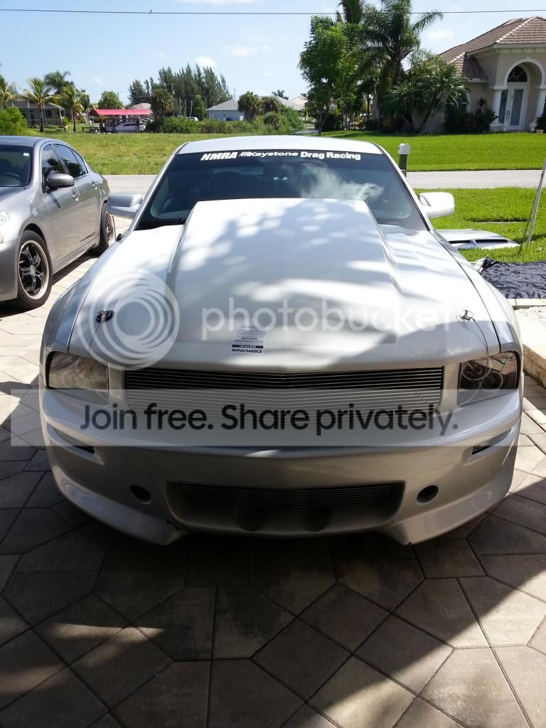

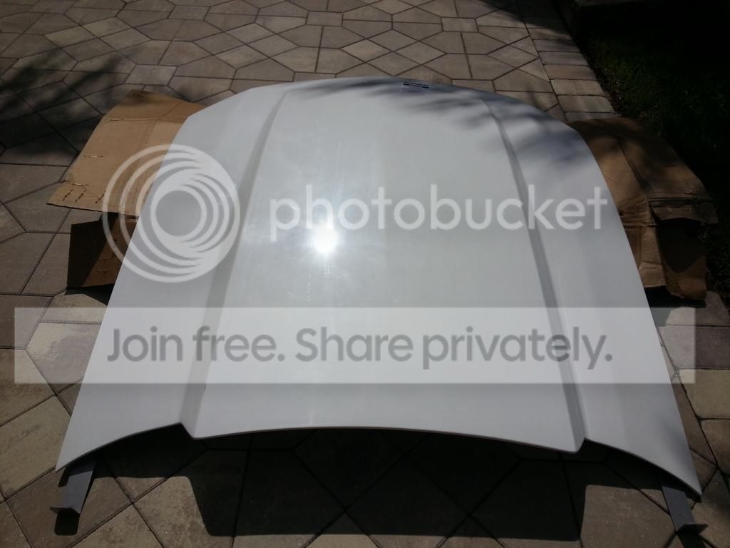

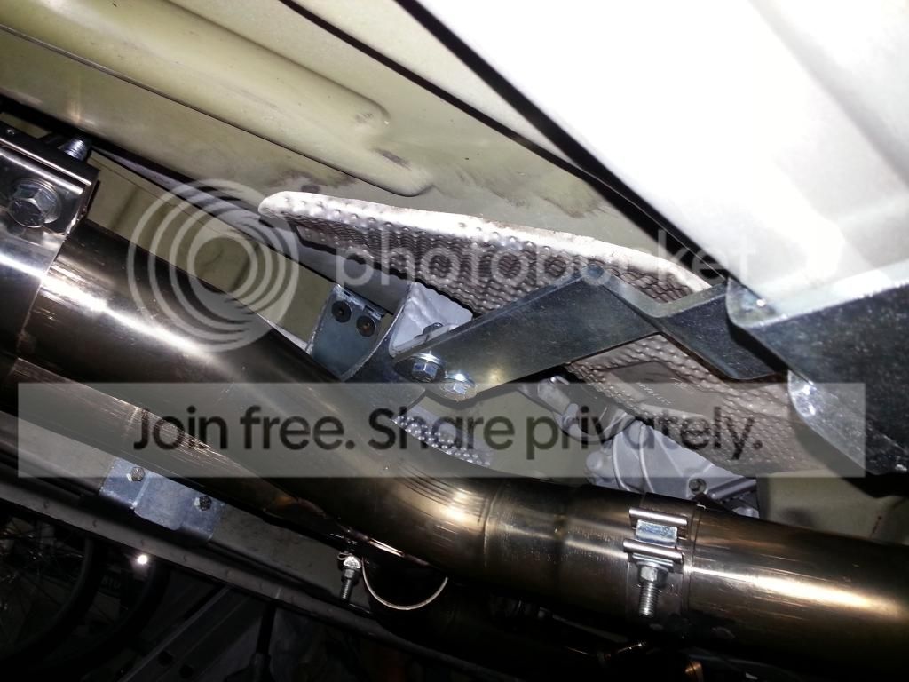

I was able to at least get a few miles on it this weekend, new motor has about 90 miles on it now, 110 more and I get to change the oil, yeah! Also was able to install the new DS loop after extending the bracket 1/2" to clear the 3" exhaust. New hood arrived Friday afternoon, test fit today, looks bad azz!
DS loop extended brackets
Modified Lakewood loop installed
New hood fitting
I think I'm gonna leave the lower billet grill off and use the IC for a grill this time :)

Tell me more about your driveshaft safety loop!!
I had the BMR loop that bolts to the tranny x-member but it hit right smack in the middle of the "X" of my new 3" o/r X pipe, there was no way to make it fit so I had to get rid of that loop and replace it with another type. I found the Lakewood model #18005 attaches to the frame rails and looked like it would work however when I went to install it I found I still needed about 1/2" more clearance over the "X", therefore extended the vertical loop brackets by 1/2" then it fits perfectly.

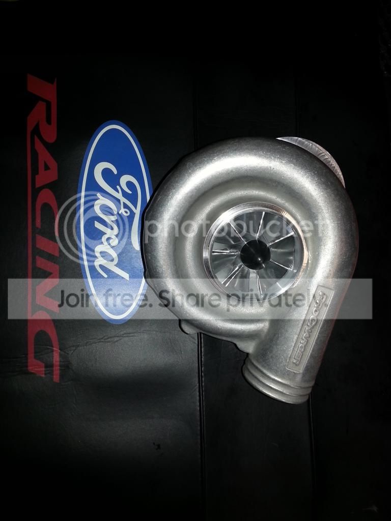

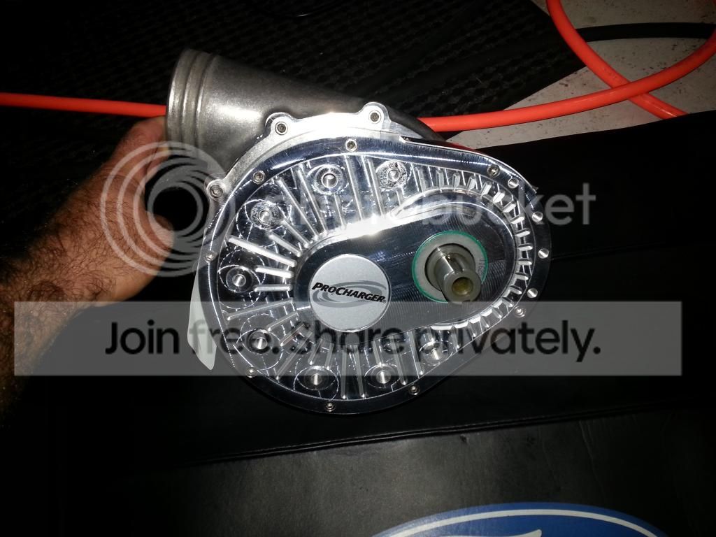

I finally got everything to install my new blower this week, including the new blower! Holy cow it only took about 2 months to get it~ Anyway, got everything installed and have been working with Lito on the tuning. I ran into a snag though with a stupid coolant leak at the lower fitting on the expansion tank, I reinstalled that sucker 4 or 5 times, wrapped it with teflon about half dozen times and it still drips after the system pressurizes. So I pulled the tank so I can try to figure something out for it this week. I would have the fitting welded on but it's brass, maybe I'll try to find an aluminum fitting IDK.

My Procharger tank used to leak when it was under pressure. I found it to be a weld on the bottom back side. Do you have an air compressor you could use to test it at about 30 psi?
