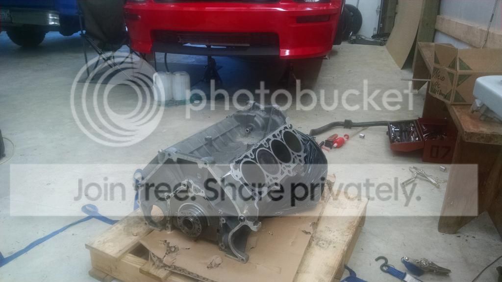

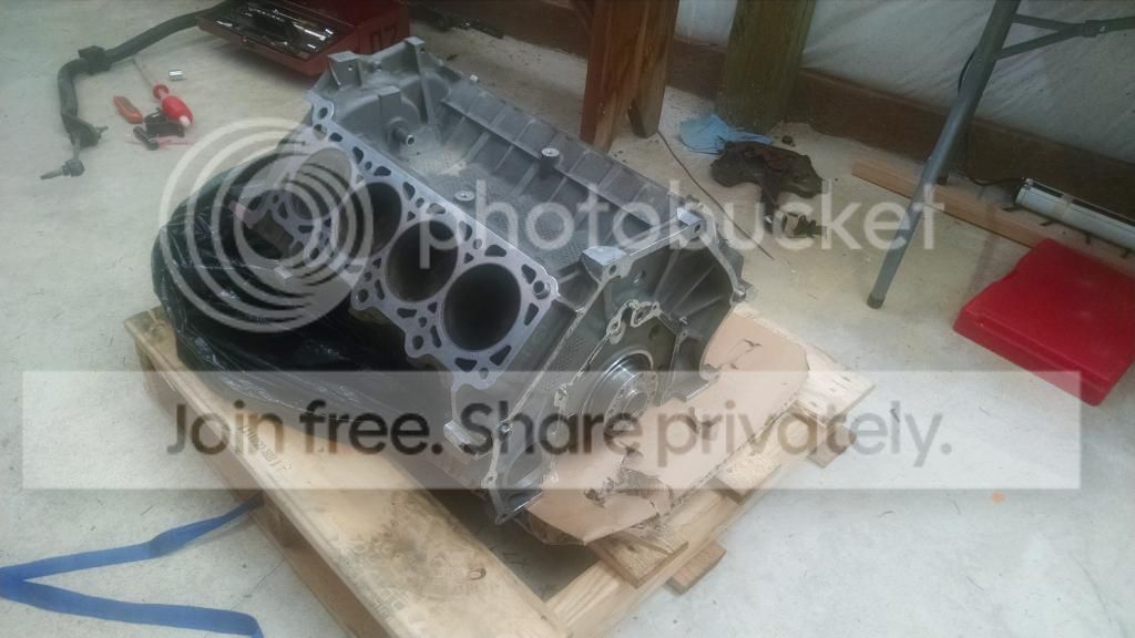

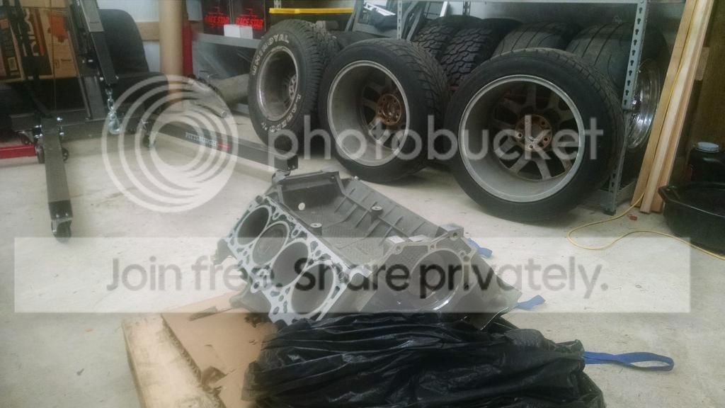

It's been a while, but progress is just about to start ramping back up again. Picked up this low mile CHP 5.1L Pro Street stroker shortblock from another member for a good deal. Hopefully I'll have this thing cleaned up and seeing boost in no time!

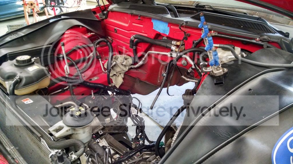

Here's another update on what's possibly the worlds slowest build. Just realized it'll be a year from my last update as of tomorrow. Jesus that's sad lol. I've been trying to hide some of the major portions of this build but I figure at this point most have forgotten it exists or already have an idea what I'm doing.

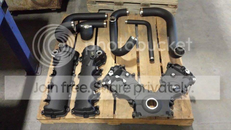

Car is a 5.1 CHP forged stroker build, breathing through a 70mm On3 kit that a buddy hooked me up with brand new in the box for a song and a dance. I also added a FRPP TB and Bruce H gave me a screamin deal on a beautiful FRPP Intake Manifold. Fuel system at this point are 39lbs injectors (whatever terminators come with) and BAP. I'll probably upgrade that later but not sure yet. At this point all the piping is coated, the longblock is all bolted up and torqued down, and will hopefully be in the car this week. My goal is to get at least one pass in before the winter but at this point who knows.

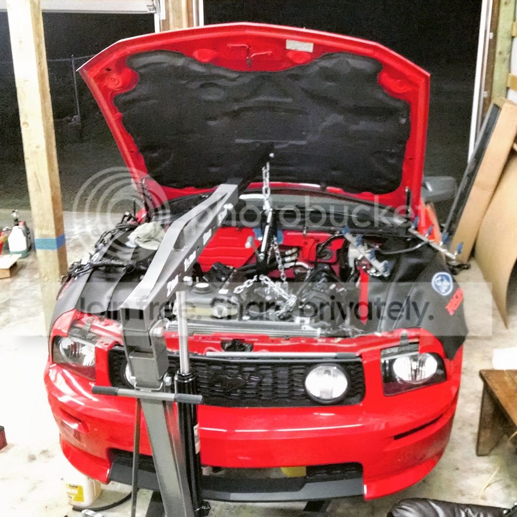

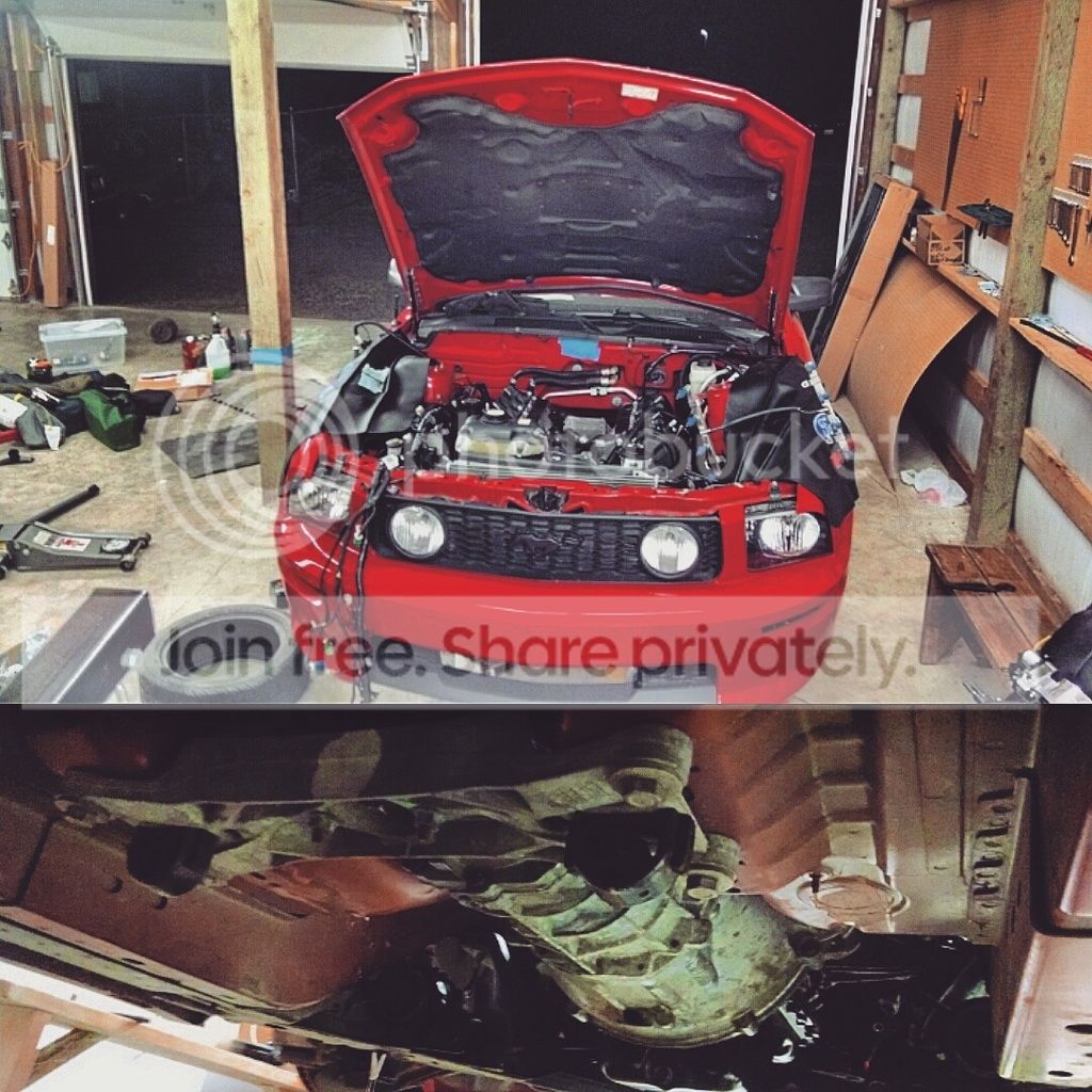

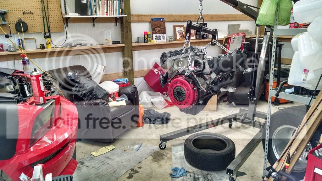

God damn this a sight to behold. First time the engine has been in the car in just shy of 2 years. Time for a beer.

Engine and transmission are officially in and carrying their own weight. Not gonna lie I'm starting to get pretty god damn excited!

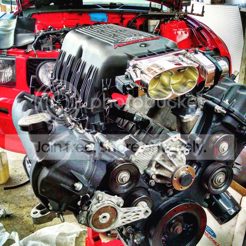

If anybody's still reading this, sorry this has become so drawn out. As you probably guessed my motivation just died when this car went down. Still plugging away at it though and hoping to hear it come to life sometime this spring, if not a lot sooner. All the accessories are now installed, wiring harness is hooked up with the exception of the coils and injectors, and slapping the intake manifold and fuel rails on tonight. Pan had been punched and tapped for the oil return on the turbo. Oh ya this an On3 kit, honestly couldn't remember whether I ever mentioned the power adder or not but there it is. Hoping to have the kit on and buttoned up either this weekend or next and get this bitch ready for tuning.

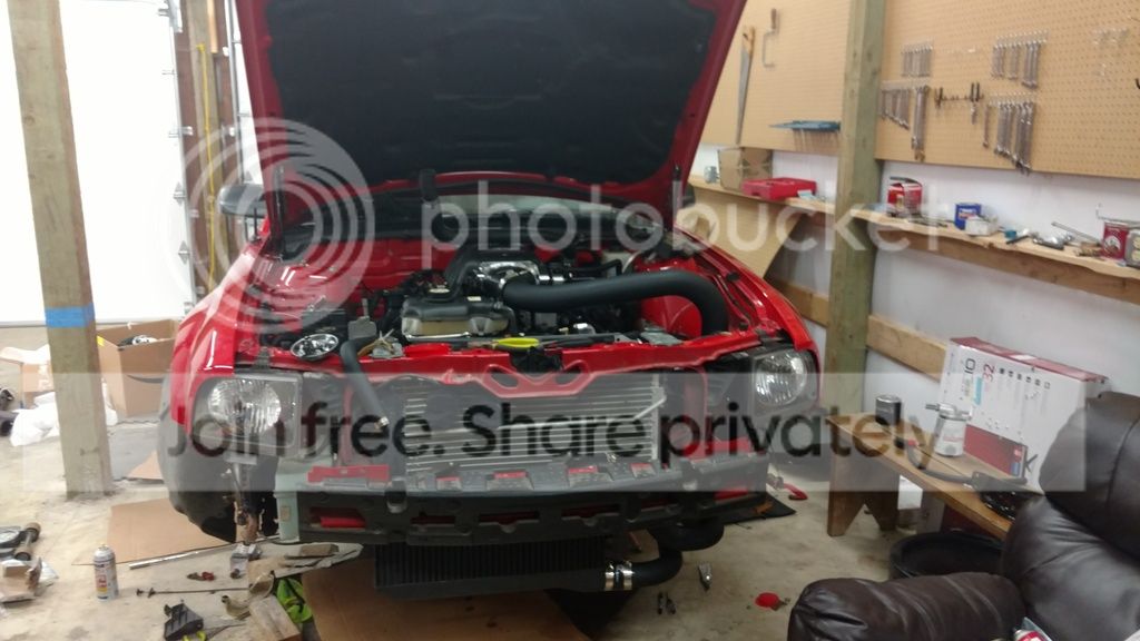

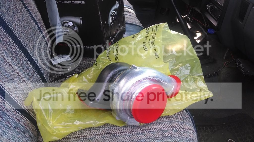

Holy shit we have progress! Going to clock my turbo tonight and try to finish up the cold side and intercooler. Can't figure out how the hell On3 expects me to mount the intercooler with those brackets so I may just be fabbing some up.

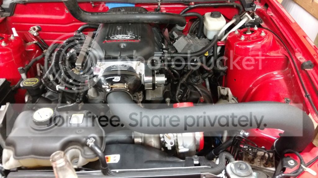

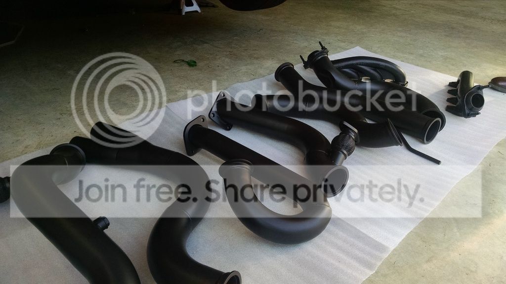

Got some more progress tonight. All the pipes are finally on and mocked up. Now I can finally see where I want my intercooler and can start working on a mount. Still have to tighten up and seal all the hotside connections, but I'm getting closer.
