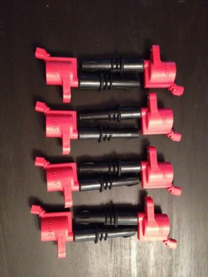

These showed up today. Got them used for $110.
I'm gonna replace the plugs tomorrow, and instal these. Hopefully that will keep me from having any issues with running high compression, and a wide plug gap.
Sent from my iPhone using it as a signal mirror.
Not sure I understand? I'm running 12:1 with stock coils and .045" gap. No problems.
Did you get a price on the sleeves? I have a teksid block here that just might get sleeved or bored to coyote size if I can find a set of cheap pistons. It should definitely be able to be sleeved for a +.020 coyote bore of 3.650".
Still though, the FRPP Boss iron block is only around 150 lbs. That's less than 70lbs. more than an aluminum 3L 4.6. Cost is $1210 new. Maybe sleeving the old Teksid would be more cost effective? Lots of options if you think about it.
The coils are just for piece of mind on my part, and for the price I couldn't pass them up.

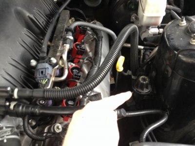

Got the COP's installed along with new plugs.
Does anyone know what this thing is and if it can be removed?
It has a hose that runs to the upper drivers side connector on the intake, and has an electrical connector on it.

That is part of the evap system. It is called the evap purge solenoid.
corey5988
Mar 27, 2013
508
South-Central KY
It has a hard line that goes back to the tray under the spare tire. I removed all of it. If you do, it will need to be addressed in the tune.
