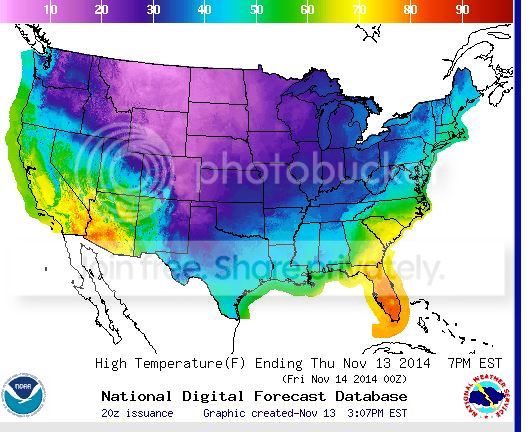

Time once again for my warning about frozen intercoolers for you "warm weather" guys, due to unusually cold temps across the country any of you running plain water or water wetter need to either drain them, find warm storage or get a 50/50 antifreeze mix in your systems before you end up with a cracked intercooler.
Happens every time we have these cold snaps.
