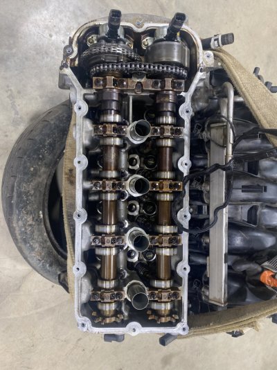

There will be more pictures available when I get them as I don't have the engine in my custody yet. It's about 4.5 hours north lol.. Should have it home by February since my work schedule is just wack for me right now. My buddy Caleb is picking through it in his spare time to inspect.
We've collectively agreed that the LH cylinder head was either rebuilt or replaced. I've never seen a factory Coyote head that has been painted but I could be wrong too.
The hex and porcelain appears to be wet with oil which, in my opinion, could be leaking plug seals in the cam covers.
The cam lobes are evenly worn and it looks like someone used a pipe wrench to turn them at some point. There are paint marks on the head bolts. I'm waiting to see pics of the cam tower caps and journals. Especially can't wait to see the bottom end bearings and such.
It's a $500 engine, lol!! I'm not expecting much from it but I would like to be pleasantly surprised.

I’d want to see what the cam caps look like. I got an engine like that and the caps were toast. The engine I bought suffered a catastrophic failure, I hope you fair much better than I did!
Sep 11, 2022
170
257
Dover, PA
Regardless, you have at least $500 in other parts there and could use the heads as cores if you needed to purchase new ones like I did. That is $500 right there. I don’t think it is a bad buy either way really.

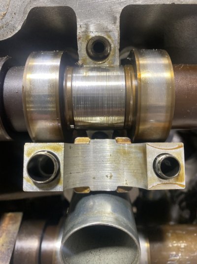

A few of the LH intake cam tower caps pulled to check wear:
Not the best but not the worst. Exhaust and the RH side shortly. I wish it were as clean as the Coyote in my SN95:
It did have 22k miles tho..

I really wish there was some sort of replaceable bearing for the cams to ride on rather than the head itself. I don’t know a lot about engine building, but a sacrificial wear part makes sense to me rather than needing to replace heads if the cam caps get marred up. I’m sure there’s a reason why this doesn’t make sense but that’s my initial thought anyways. My heads were much worse than the wear I see in these photos. You could catch the grooves with your nail on the ones I replaced.
Like this one?
It’s apparent they changed the LH head and this cap was in the RH head. It was just that one cap that was in this shape.

There used to be offerings for bearings to go in the cam journals. I have a set of 2v heads that had bearings installed in the cam journals. I don’t know anyone doing that work anymore though

Hey Will, I forget you're here! I believe it was Sean Hyland that was doing it.
