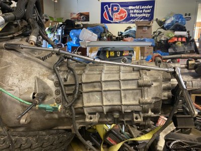

Jack the front of the engine up, this will lower the rear of the trans and give you a clear line of sight to the bolts. Like I said. Then a combination of the right tools and it becomes quite easy. I grabbed my 3/8 for this pic, use 1/2... but you get the idea... you can blaster the hell out of it from here to if so desired.
Or go two steps forward three steps back, to each his own. Good luck.

That's an amazing demonstration to follow. Ill give it another shot and blast it again with PB. Thank you so much.

Update, got the bolt. Wasn't bad to get after taking a brake and revisiting the situation. Also huge than you to WNYGT5-0 for the help. I used your socket rig as a template for my own and got it in about 5 minutes.

I had to take my intake off to actually remove those bolts, BUT those things were super tight! I couldn't get them with 2 wrenches linked together, I ended up making a breaker bar sort of tool as it was the only way I could get something in there that was long enough to break it loose (this was a tool I'd made a few years ago for a belt tensioner on one of my former vehicles, I just bent the handle to clear the firewall)Snapchat-759960002.jpg
