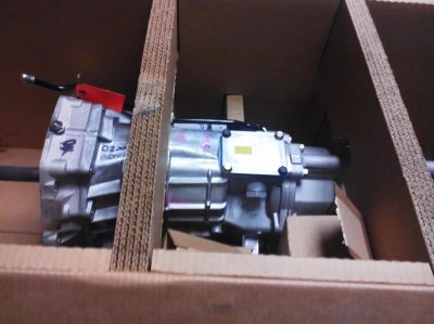

Now waiting two months to install... :ugh1:
