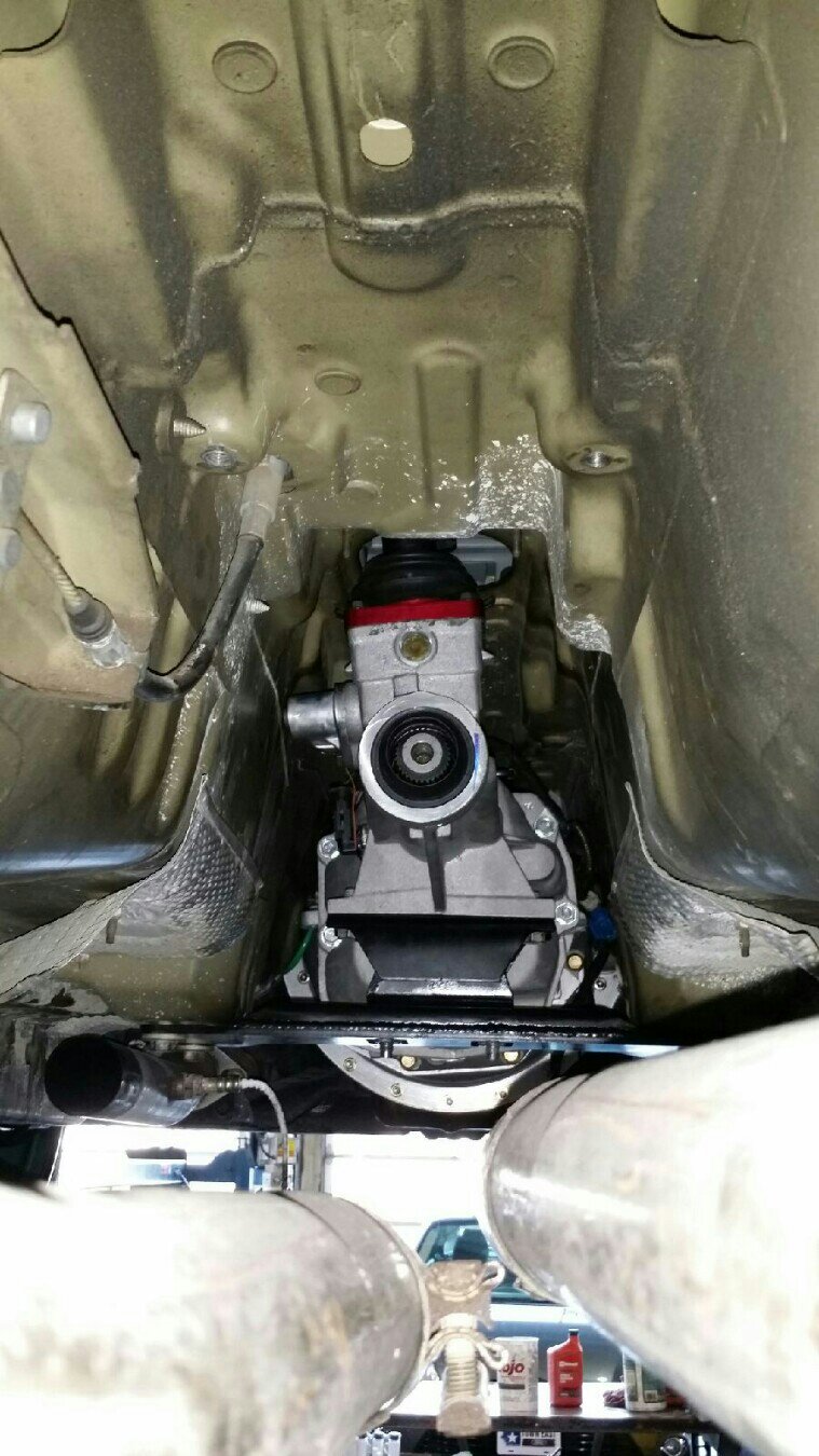

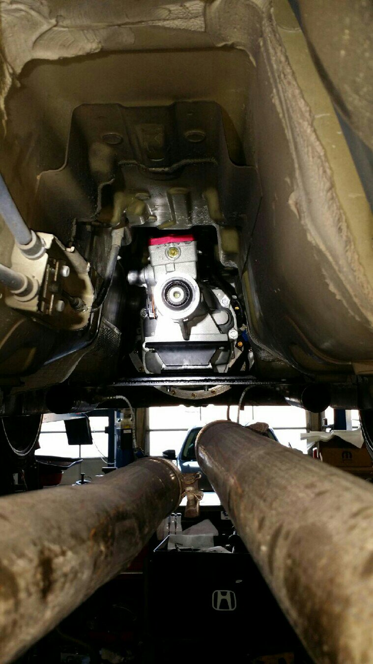

did anyone do their own t56 magnum xl install? was doing mine today and noticed that the tailhousing/shifter housing looks slanted or twisted to the left

My installer told me this too. He checked with tremec and it was designed that way.

Yes it's normal. I was surprised how tight it was getting the wiring plugs hooked up again. Trans was pressing against the tunnel pretty tight on one side. I tried prying it out while tightening down the trans mounting bolts but ended up having noises and binding issues. Loosened up the mounting bolts, let everything relax and snugged the bolts back down and no more issues. It's just fucking tight!

Man I sure hope so! Looks crazy haha but if I were to put the shifter in it is centered so I figured most likely normal. Thanks!!

I did, and yes it is normal. Remember the shift lever is mounted to the right of the shifter protruding from the tranny, so once the shifter is in it will be almost centered.
