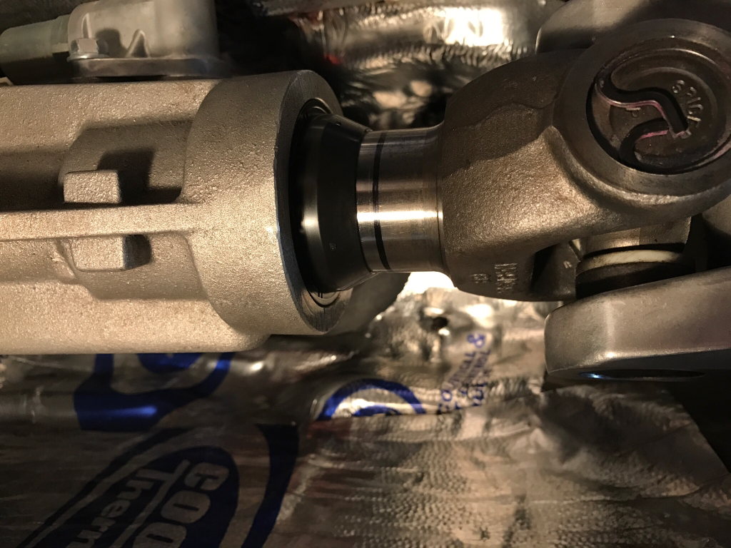

Have you checked to see if your driveshaft is bottoming out in trans. With that torque arm you need adjustable lower control arms and if they are adjusted too short you can bottom out driveshaft causing noise under light load when cruising. I put a mark on mine showing where it is bottomed out and then checked it after install. This is how mine sits with no issues. You can tell it's bottomed out if you go to remove it and it is very hard to pull out from the slip joint.

Hope you get it figured out. Did you check your driveshaft slip joint clearance to make sure sure it isn't bottoming out?

I did check the driveshaft slip distance, like you suggested, and it fine.Even after I shimmed the trans tailpiece to align the drive angles. And I put in MTL as you suggested as well. That noise is a real kicker. But all that's left is the clutch, I've replaced (or rebuilt) everything else...
