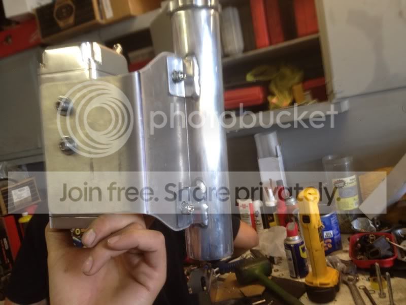

I bought two each of these *Overflow and Catch can* then fabricated the bracket to make it work symmetrical in the car.
