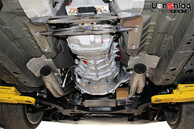

PRODUCTION DRIVESHAFT INSTALLED
We've seen a couple of "one off" LS swaps on the S550 but not any comprehensive "kit" that has engine mounts, trans crossmember, long tube headers, driveshaft, and transmission solutions. We made a decision early on to attack the Road Race customer first, and they don't want a Powerglide or other automatic, they want a manual transmission. The T56 Magnum XL is THE best option for road course use under $20K, and the bellhousing-to-shifter length is perfect for the S197 and S550 chassis Mustangs, so that is what we built our "Stage 0" kit around.
This makes for a much shorter driveshaft than the long 2-piece OEM unit that came on any S550 - because the direct shift T56 Magnum transmission is much longer than the remote shifted Getrag MT-82 6 speed in the 5.0L Mustangs or the Tremec TR-3160 6 speed from the Shelby GT350. Since this Tremec T56 is so different from any OEM transmission in this chassis, there is no way of adapting the stock prop shaft - we needed an all new design.
The T56 front slip yoke is unique to that transmission and has a standard U-joint. Out back also uses a U-joint, but as we have learned the hard way (see our 2018 Mustang build thread) there are TWO different sized rear differential flanges in the S550. Our driveshaft supplier makes a universal rear flange that works on both diameters, using a second set of holes and a spacer shim that goes inside the flange.
Once all of the OEM bolts and binary washers arrived we were ready to install our production driveshaft in late July 2020. The stock binary washers (which we sourced from Ford) needed to be shaved down a hair when we used the radial shim to adapt for the smaller S550 flange inside the rear axle flange cup. You won't need to do this slight modification if you have a rear axle flange cup that has the smaller diameter - as you won't need the adapter ring.
Other than that slight tweak (we will have these modified binary washers laser cut and offer those + the OEM bolts for our driveshaft kit) the driveshaft install was a breeze, and the large diameter unit looks plenty beefy. Shouldn't be an issue with our 550 hp engine, but the more powerful "Phase 2 engine" might get a carbon shaft. We will run the numbers and see.

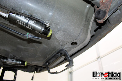

Many things on this salvaged S550 chassis were missing, and when we bought the used fuel tank all of the internal bits were long gone. So I reached out to my buddy Paul @ Tri-State Auto Parts, just outside of Memphis. He has helped us track down a lot of long lost items for this build and others!
Paul likes my memes so he sent the box marked as such! He helped us source some fuel pump parts/sump, used ABS units, various wiring pigtails, and more.
Having nothing of the stock harness makes for a lot of extra work, but I was in a rush when I picked the car up in a made 38 hour straight road trip, and missed this very obvious issue (missing harness). Again, starting with an utterly stripped car likely cost us 6 months of time and many thousands of dollars in extra parts / chasing. Live and learn.

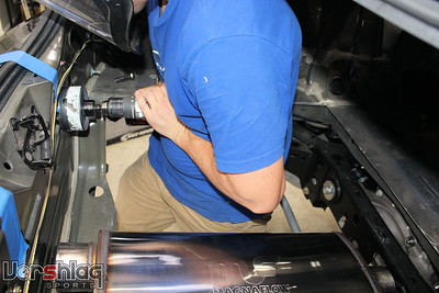

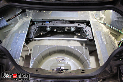

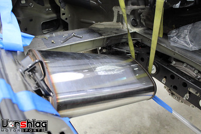

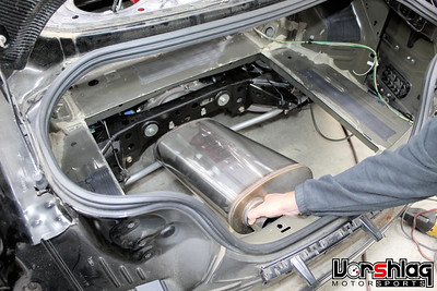

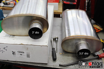

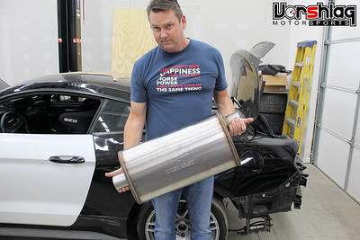

UNUSUALLY LARGE EXHAUST PLANS
So I am a bit of a nut when it comes to exhaust systems. Having built a lot of lighter, higher flow exhaust systems on a lot of cars over the past 35 years I have outgrown the LOUD AF systems. When I was in high school and college I had the Flowmaster stuff with dumps on a variety of 1st gen Mustangs to Fox Mustangs, but I can't deal with that noise anymore.
Honestly, a lot of event sites are tired of that nonsense as well, and more and more have put into place noise restrictions. Many have a 103 db limit, which we have been able to hit with some of our customized exhausts. The off-the-shelf Magnaflow install on my 2018 GT was SUPER loud (above left), but the upgraded version (above right) would regularly measure between 90-97 dB - which is a LOT quieter than needed to squeak under 103 dB tracks like NCM.
The thing that we have found that reduces NOISE while keeping the same or increasing FLOW is to go with a larger diameter tubing on the exhaust and a MASSIVE increase in the muffler case VOLUME. We have done this on a lot of cars and it usually INCREASES horsepower while DECREASING noise levels (measured with proper sound metering devices and SAE procedures).
Big mufflers are always harder to package... so the exhaust companies don't even make "kits" like this. Which is a shame, because this really WORKS. Unlike the S197 above (which has a custom 4 muffler 3" mandrel bent system) the routing on the S550 does not leave as much room out back for a large muffler case - and with the power level we are going for in Phase 2 we need the biggest mufflers money can buy.

PICKING TWO MASSIVE MAGNAFLOW MUFFLERS
The solution we have used many times to counter noisy exhaust notes on rowdy engines is to use a larger case muffler. The biggest muffler we have ever used on a car is this Magnaflow stainless 5 x 11 x 22" case beast, shown below.
We have installed one of these onto #TruckNorriSS, my 2000 Silverado with long tube headers and an HPR built engine. This truck used to have two smaller volume, chambered Magnaflow mufflers and it was pretty damned loud. The change in sound levels after we installed this SINGLE muffler was immense. This was a dual 3" into single 3" merge into this Magnaflow 12589 muffler. It did not lose any power, just got a LOT quieter.
Right after this truck exhaust change I new what the LS550 needed - two of these! Sure, they are eighteen whopping pounds apiece, but the peace and quiet of having a quiet Mustang would be worth it.
I laid out a scaled drawing of the mufflers onto a picture of the S550 trunk very early in this build, sent this to Magnaflow in an email, and asked them to sponsor a pair of these for our LS550 build in late 2019 - and they agreed. Later in 2020 when I checked up on the sponsored mufflers, they had to stop their sponsor program due to Covid, which was totally understandable. That's when I just bought two of the 12909 mufflers in the 3.5" inlet/outlet sizes I wanted to use (the 14900 versions shown are just polished vs raw stainless).

TRUNK CUT OUT
To make room for these two absolutely massive mufflers we cut the trunk floor out of the Mustang, which we do on a lot of race cars that will be getting a diffuser anyway (this one will get a diffuser, eventually). In December of 2020 we mapped out and marked out the "line of death" and Brad got to cutting...
We planned to take the cuts up to the edge of the main structural frame members and main lateral structure member in the back of the car, with a 1/2" flange left to attach to later. We would lose the ability to carry a full sized spare, which was a non-issue.
After some careful cutting the spare tire section was cut out, which totaled 8.9 pounds. More importantly it gave us room for these big mufflers.
"So much room for activities!"

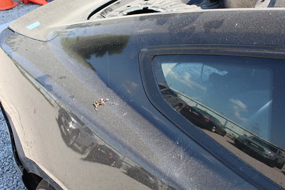

RETURN TO THE SHOP - AUGUST 2021!
After many months of barn storage the Mustang came back into the shop. I had to wash the filth off of it first, as it was stuck under a tree for a few days back when the barn got foam insulation sprayed.
This car was NASTY but cleaned up quite well, since Brad had waxed it before it went out to storage. Washing this car was very cathartic.
Seeing it cleaned up and getting it back into the shop was a huge boost for me, mentally. I've been away from Time Trial competition for TWO YEARS now and it has made me grumpy AF. This car is what I will drive next on track in that format, so getting this going again is a way to shorten that gap in my track addiction.

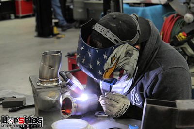

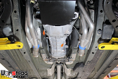

FINAL HEADER COLLECTOR MODS + CERAMIC COATING
The production LS550 swap headers had been in the car for some time, but to fit the 3.5" exhaust we'd have to steer the collectors around some items, for a better aim at some open spaces in the floor pan, aft of the headers.
Our newest fabricator Zach stepped up and mapped out the curves with 3" mandrel bends, cut them to fit, tack welded them together, then added 3" V-band flange to the ends.
These collector bends were finish TIG welded, the welds inside were sanded smooth, and these were then welded to the ends of the collectors.
With the headers reinstalled one last time to check fit they were removed, and I took them to be ceramic coated along with the re-used headers from the CTS-V.
The difference was amazing! The old Caddy headers look brand new, and even the new "raw stainless" LS550 prototypes look like a million bucks. The entire exhaust is getting coated when it is complete. We might still DEI heat wrap some areas of the exhaust that are close to things we don't want to get hot, but for the most part this coating will drop lower underhood temps all on their own - while looking very sharp. This coating is very durable (we've used this place / this coating on exhausts before) and if it gets covered in oil it can be shined up again with a Scotch-Brite pad or steel wool.
FITTING THE MUFFLERS
This step shows how Zach fitted these mufflers to the rear of the car, starting in August 2021. Sadly the two types of muffler mount bushings were SUPER delayed in getting here and this pair of mufflers isn't 100% mounted yet - just held in place by straps. Which is holding up the rest of the exhaust, but within days of me writing this these delayed parts will arrive...
Zach understood where and how I wanted these mufflers mounted and he pushed through the obstructions to make it happen. The initial opening in the rear trunk wall (above left) was done with a 4" hole saw, leaving an air gap around the 3.5" tubing diameter. The second hole (above right) was on a weird slope and angle, but was cut the same way - just with a lot more effort.
These two cuts allowed the back of the muffler to tuck up close to the back wall of the trunk, and then the tips can make it all the way through...

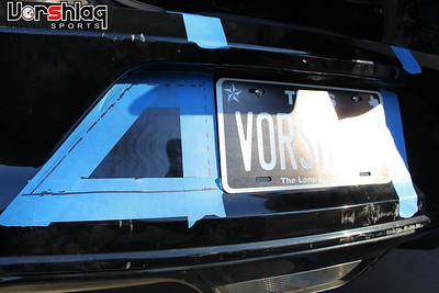

EXHAUST TIP SURROUND
Now I will admit this part is seems a little "showy", but it was necessary to make the exhaust tips exit high in the chassis, next to the license plate frame. There is also a practical reason for this.
We have done unusual muffler tip placements before, in order to squeeze the biggest mufflers under a car - like on this C5 above. We ditched the normal double 90 deg bends the C5 uses and added Magnaflow mufflers 2x as large as the OEM units by taking this unusual path (and removed two 90 deg bends and added one 45 deg on each side). This routing necessitated side exit tips, and these stainless steel heat shields (which are brushed finished, and easily cleaned when they get a coating of exhaust soot). One of the best sounding C5s I have ever heard, and quiet. Picked up 25 whp with this exhaust change, too!
On the LS550, to get the even larger 5 x 11 x 22" case Magnaflows to fit between the rear axle the bumper cover AND be above the future rear diffuser top plane, they need to start low and angle upwards (we will cut the back of the bumper cover at the trim line below the license plate frame).
