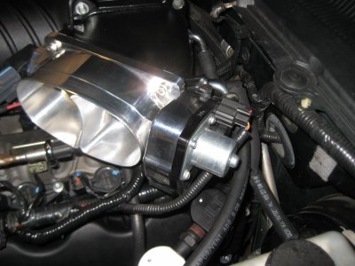

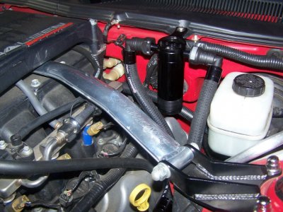

Running 2 of them inline will provide much better protection. The only reason I run just a single, is I also have a CFM billet oil cap breather that includes a built-in one-way check valve that opens up when under boost. When the check valve is open, it prevents the crankcase from pressurizing during WOT and boost. Under normal driving conditions, the check valve stays closed just like a regular oil cap. The catch can I have, is the UPR 4 chamber design that works flawlessly in preventing crankcase oil vapors from reaching the PCV barb connector at the intake manifold. Here's a couple images of my catch can and CFM billet oil cap breather. 000_0624.JPG 000_0540_384fa1913aa7b15bb10e90b75e7f806cfd2100c5.jpg
