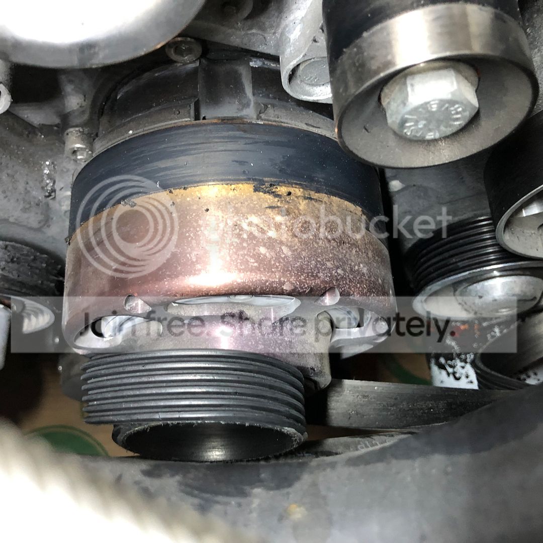

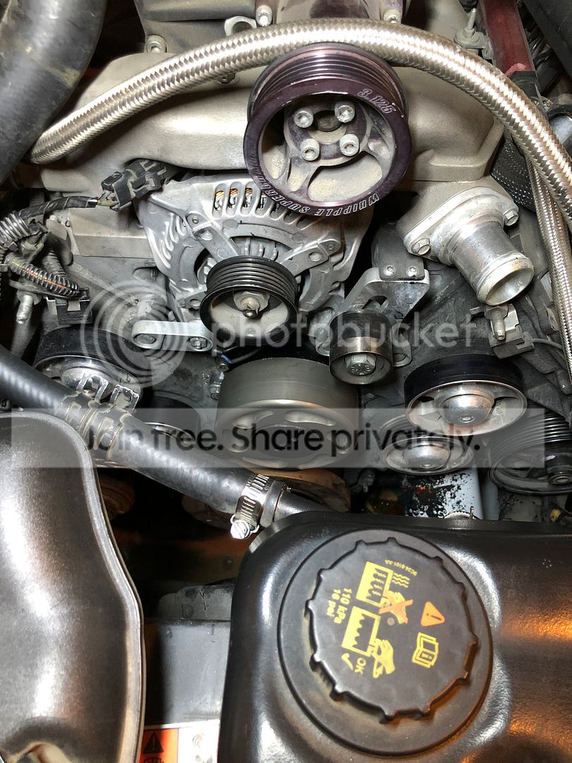

Swapped out the HD water pump for my old regular electric pump. Gonna take a look at why this dummy pulley seized up then send it off to Meziere to rebuild it if it can be salvaged.
Busted newer pump with HD pulley. You can see how hot it got. The belt melted to the pulley.

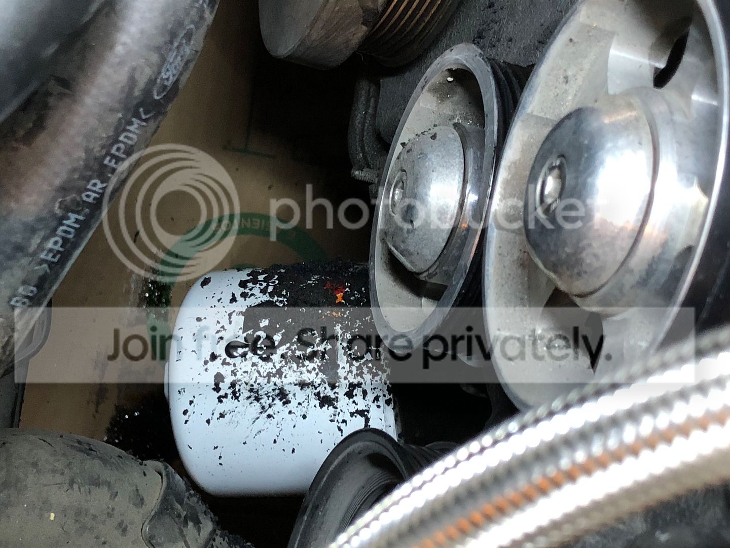

New old regular pump. You can see all the melted rubber flung onto my oil filter.

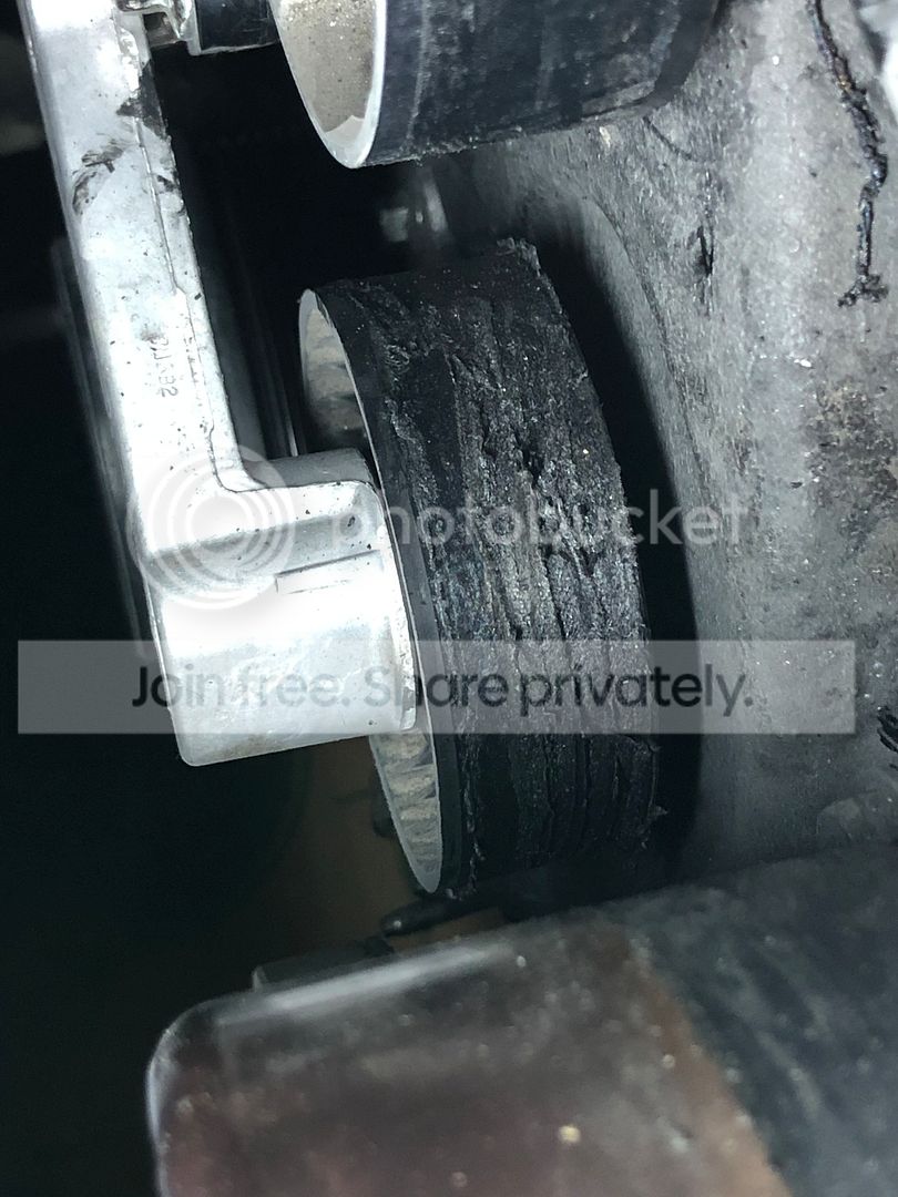

Replaced the effin plastic tensioner pulley with a billet one. This thing got wasted when the belt melted and snapped.

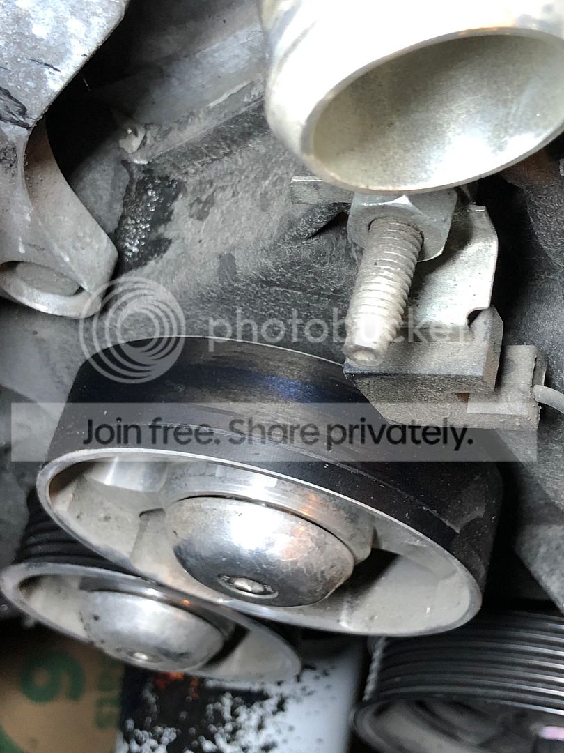

Must have gotten pretty darn hot to blue the finish on my billet pulleys.
Even the adjustment pulley for belt length has the belt melted onto it.
