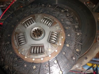

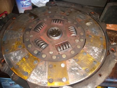

So, I was cruising in 5th datalogging on rt1, 60-ish. For the exit, I popped in neutral, idled at 1000 to stop. I put it in 1st to make my turn, hear some scraping sound. Let the clutch out, sound stopped car will not move. Pedal feels like its over adjusted, no play. Did I mention I dont have my phone with me? If it moved, it would have been no issue driving it back home. I have never seen a clutch go out like that. And I had the trans out a few thousand miles ago, clutch still looked almost new. I dont drag race, so there is no abuse on the clutch. I am baffled what it could be. Its in the spot where I will be pulling the trans, just time from here. And the auto adjuster has been replaced with adjustable cable and fire wall adjuster. I thought about just unhooking the cable and see if it would move, but said fuck it, just went and got it with my trailer. I now own a 12 v winch. lol
Its not a t5 btw, it was auto originally. I swapped it with the 3550 swap kit.

Pulled the 3550, found my clutch issue. What a way to spend the 4th!
The friction material came off the disk. Wonderful. Well, it has been in there for 15 years. But I was expecting to wear it out, not for it to fall apart.

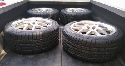

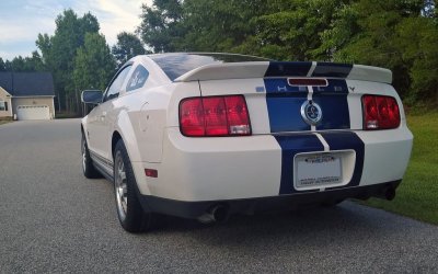

Received 4 brand new Cooper 255/45/18 tires, which will get installed on the wife's factory GT500 18x9.5 wheels and will probably get used twice a year: to and from the state inspection place. Tons of tread, and they will fit front and rear on both cars, her Shelby and my GT
Can't wait to see how well they hold the 650 rwtq of the Shelby ... LMAO

IMG_20220711_175502988.jpg IMG_20220711_175450636.jpg IMG_20220711_175438355.jpg IMG_20220711_175417540.jpg Clutch failure identified. This clutch was installed 2006-ish when the 3550 swap went into the 91. Has mostly HPDE miles on it.
