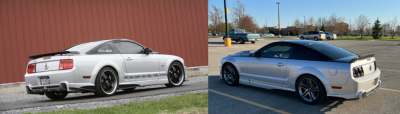

Took the wife's Shelby to work, it needed to be driven a bit more to go OBD-ready.
It's got the catalyst monitor hanging, but we're allowed one "not ready", so we should be fine.
Got it home and installed the 255/45/18 tires with the OEM wheels.
It doesn't look as silly as I thought it'd look, lol
Going for the state inspection later in the week, then the Alcoas are going back on and these are going on mine, for that car's state inspection, :)

That color combo with those wheels is my favorite version of the GT500. I’d love to own one just like that one day!

Yes, definitely a classic combo. When I first met my wife and she had just gotten it about 2 months earlier, she was telling me she wasn't in love with the white, I told her that's crazy, it's THE classic combo.
Also, I keep saying that if/when I get a GT500, it will have to be blue with white stripes, her exact opposite :)

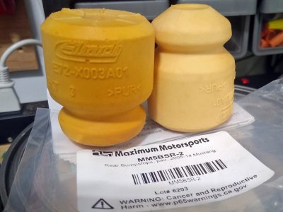

Today I replaced the rear bump stops in my '13. I recently found that the left one had basically split open, broke apart or whatever. Guess I may have cut it down a bit too much and one too many bumps.
I went with Maximum Motorsports ones, which as it turns out are nothing more than Eibach pieces. When I googled the part number I came up with front Honda Civic applications. Interesting to think that I now have front Civic bumpstops in the rear of my Mustang. Not sure how I feel about that, lol
To install them you have to remove the old rubber pieces and insert the new MM/Eibach rubbers upsidedown. I sprayed the metal bracket with a little detail spray to make the insertion of the new stops much easier.

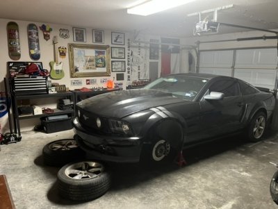

Got it inside and on jack stands to finally do my inner and outer tie rods. Got the boots loose and inspected them, they really don’t feel like that have any slop in them but they are absolutely not as tight as the replacements. Hoping it clears up my annoying 50-65mph steering shake! If it doesn’t I’m running out of things to check..

what have you checked/done so far?

New parts recently replaced includes: shocks, struts, strut mounts, front lower control arms and a sway bar kit. Tires are less than 2k miles, wheels were balanced when they were mounted. I’ve confirmed those little brake disc retainer clips were removed and all lug nuts are tight. I am running wheel spacers but didn’t have an issue when they were freshly installed. The shake became more apparent after a little track day so I also changed all the brakes just to eliminate a warped disc etc..
All the old ball joints on the tie rods are pretty loose and easy to move by hand while the new ones are super tight so I’m hoping they’re just worn out. I’ll get them changed out and see where I’m at from there.
