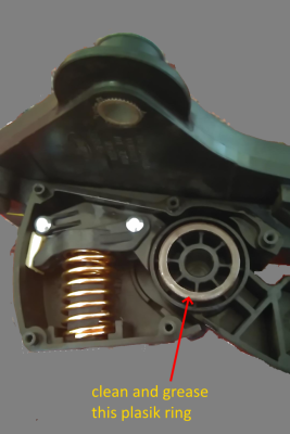

Greased and cleaned the accelerator paddle. The paddle did not operate in a smooth way. I opened the housing and cleaned/greased the plastic "bearing". Used silicon grease for PU bushings. Unfortunately I don't know how to remove the spring to grease the other side, now it is much more smooth than before :)

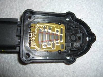

Is the white looking piece on the end of the APP arm a shim adjustment that positions this arm at full pedal travel rest?
It sure looks like it to me...........
Just curious from seeing this unit opened up here...............

I have not dissembled the white arm, just cleaned the plate with alcohol. The zero position of the metal brushes is on the contact area.
