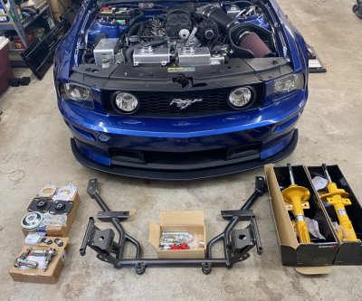

Long overdue stockpile, . BMR K-member, gt500 control arms, Koni sport struts, Maximum motorsports caster/camber plates, Shelby bumpsteer kit, replaced cut rear bumpstops with frpp's. All handles better but do feel more vibrations at low speed and particular the starter from the motormounts. Plan to add A-arm brace (had CHE k-member brace with tq limiters, can be made to fit but probably just sell it), and considering rad support and brace. Rear is already Watts link, LCA, LCA bracket, adj UCA, sway bar with billet links, and K-springs & Koni sport shocks. Front already had K springs, swaybar with billet mounts and strano links, traded out Tokico d-specs.

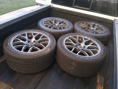

Just sold these wheels. For the first time in as long as I can remember, I only have one set of wheels for my Mustang.
Time to look for the next set! :D

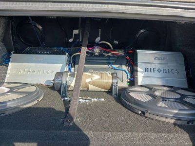

Replaced the Kenwood Mono amplifier and kenwood subs. Looking for more thump in the trunk. Replaced it with a 1200 watt amplifer.20221014_104905.jpg

Built a fan setup for my trunk to keep my 3 amplifiers cool. Used 2 - 20221027_212908.jpg 120mm, 12 volt fans, and wired them to a relay and temperature controlled switch and fan speed controller. The relay will be triggered by the amplifier turn on circuit, and the fans will turn on when the preset thermostat temperature is reached.
