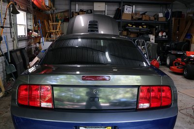

View attachment 87025 I finally got around to doing some more body work on my fully shaved trunk lid, just reminds me how daunting body work can be, I finally think the panel is smooth, pin holes and other spots pop up.
repeat and repeat

thanks, for the 3rd brake light I just got a piece of sheet metal and used metal snips to cut it out, pretty easy as the 3rd brake light hole has a nice lip/flange for the sheet metal to sit.
for the holes left from the key hole and emblem, I bought some round premade sheet metal plugs from east wood and jut used a unibit to open the holes up to the plug size

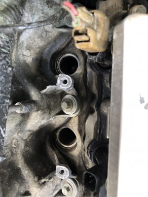

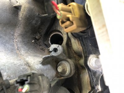

Daughter said the GT was running rough at idle but only on a few occasions. No CEL just every so often.
Did the usual, visual inspection then voltmeter on battery and while running... Checked for vacuum leaks and loose wires, etc. So far nothing found and the car is running good...

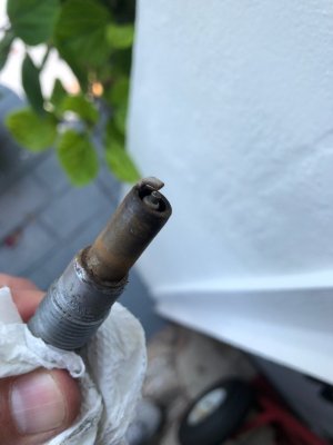

Decided to check the sparks plugs... noticed coil was loose. Tried to tighten it down and bolt just spins. I quickly realized the aluminum valve cover boss is split (over tightening, corrosion, heat?). Checked the other 8 plugs and notice another coil is loose. I tie-strapped them down and will epoxy the holes and re-tap next week. Also, after 30K+ miles I will change the Brisk 3VR14S, but not sure if there are any other options? I had Autolite HT0 on my 06' GT and they performed well. Any input or recommendation would greatly be apricated.

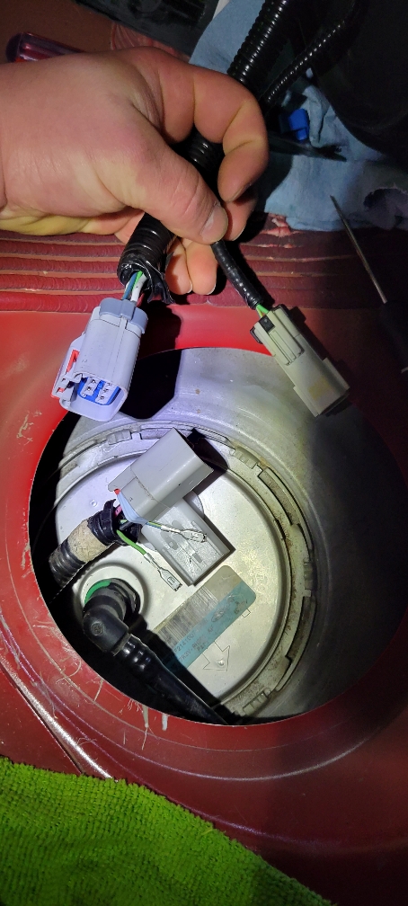

Started installing my duel fuel pump but hit a wall. Seems to be missing some connector but there's no actual parts list. Up next is the rear suspension.

Just a recommendation....you might want to vacuum out the dirt around those plugs holes (or blow them out thoroughly before removing the plugs). Sand doesn't do engines any favors. Actually your plugs look good. Just wire wheel them and check/reset gaps and they should be good to go. Brisk are expensive but IMHO the best you can get then probably Autolite.

You are correct, Those Brisks are still good but time for a fresh set. Just ordered the HT0 from Amazon $68.00.
I will fill in and then tap out the two coil bosses too.

Body work is a bitch! I recently tried to fill a bunch of chips before i wrapped my hood. I had to do it again because i had some nasty high spots in my primer. it's still not perfect, but it's passable now at least.

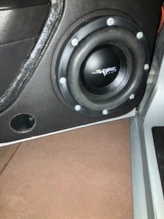

Finally got tired of not being able to hook up my iphone and play Spotify and even plug in a thumb drive on my shaker 500. Over the last two weeks I installed a new Kenwood touchscreen multi media deck, 4 Kenwood 6 x 8's, and 2 Skar Audio 8in subs in the doors. Running a Hifonics Brutus Gamma 1000w 4 channel AMP to power the 6 x 8s and a Skar Audio Monoblock AMP to power the subs. The Skar Audio 8in subs are shallow mount but I still had to do some dremel tool surgery on the inside door panel to make them fit.

Changed spark plugs and repaired valve cover bosses with JB weld.
Before
After
So what’s interesting is… my machine shop guy where I got the special 5mm tap said this is due to arching from the coils. Never heard of this before? I cleaned everything, sanded all metal and applied die electric grease. I hope this resolves the problem.

Ah dang. They worked. Was debating the 8" Skars. I am gonna throw a set of 6.5" speakers in the 8" slot.

My door panels looked bad enough and the fake red leather finally fell off long ago so I decided to port it with a hole saw just to see what happened. Sound's much better. If you're curious they are the Skar VD-8 subwoofer, they need the extra airflow.
