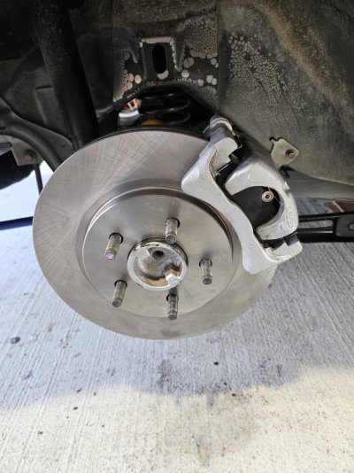

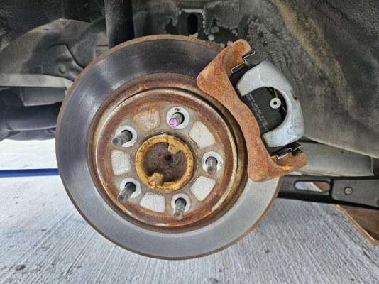

Autozone has a buy the Duralast brake discs, get the ceramic pads for free. While the dealership replaced the pads at 110K, prior to selling to me@ 112K (now at 115K), I couldn't pass up the opportunity to replace the 17 y.o. rusted discs, getting "free" ceramic pads in the deal. I also took the opportunity to "rebuild"...(read high-temp rattle can metallic silver paint) the caliper bracket and caliper frame, and have new rear brakes. Gonna order the front slotted/drilled discs, getting the front pads for free, as well. The deal is until the 4th...

With the before pic, there's no doubt she sees salt, but man silver paint makes a huge difference
As 86GT said, it's spent its entire life in Louisiana. See my response to his thread, below.
Yeah, I bandied about red (overdone, IMO), black, Vapor Silver, etc....but settled on metallic silver. Went with the Krylon Fusion, and I think it turned out great.

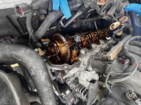

Replaced the cam phasors because I had a rough idle occasionally with a very intermittent phasor-related DTC code, and because I drive the fk outta this thing (yet somehow my factory clutch managed to survive 150k miles.)
My driver side phasor was the one giving me trouble, but swapped them both out. Then did a compression check just for shits and giggles and found my #1 cyl is at 160 psi. haha, whoops. All others are at 210-220 but I think #1 is just a dirty exhaust valve. The cylinder wall cross hatching looks impeccable. Ready for another 150k. Good yard.
..Also peep that gold color hahaha that's what I get for running 5w20 like Ford told me to do :angry1:

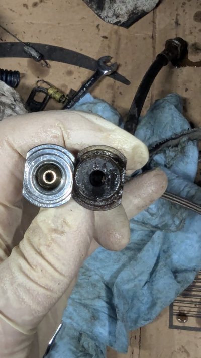

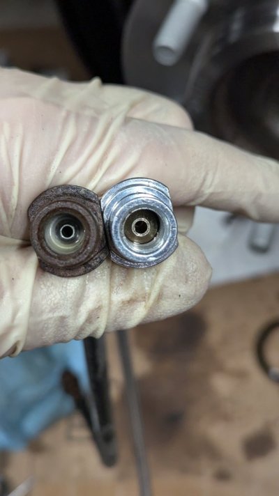

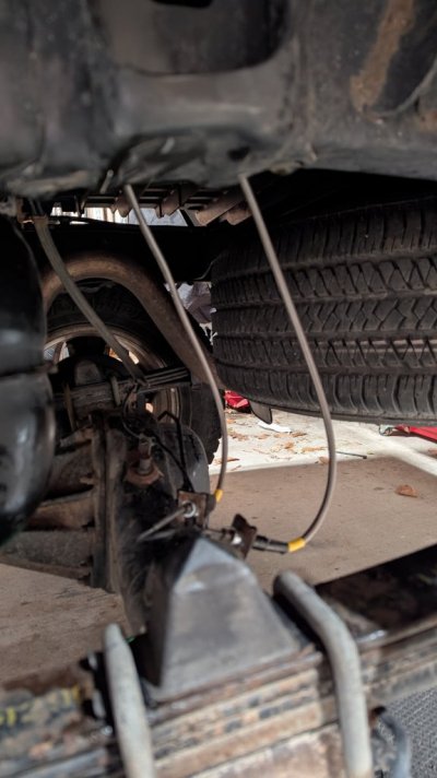

Doing a larger overall job to my Tacoma, and was installing Stop Tech stainless braided brake lines. Was amazed how little the brake lines fought me when removing them, but print the new ones on was another matter. One side slipped into the bracket nice and easy, but the line for the other side I couldn't get to seat for the life of me.
Then I took a second look at the shape of the ends on the original lines... Yeah they're not the same. Note that one is just a circle with the sides clipped off, and the other is like a cat eye. But the stainless fittings are both circular. Time to fire up the angle grinder... (Just used the edge of a cutting disc to reshape into a cat eye)
The upper connector is similar to the Mercedes type. I used my old hoses as a plug for future repairs. I cut the hose in half and pressed hot glue inside.
