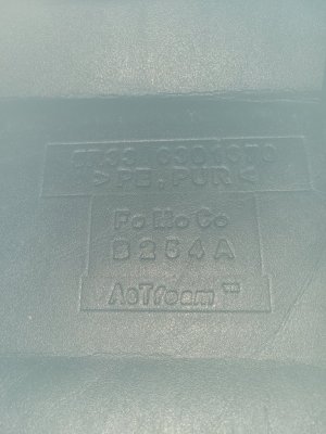

Just got a 2006 mustang and I'm going through the TSB to find/mitigate a water leak. I gutted the car and tore out the old carpet since it was wet and stunk. There's some foam stuff under the dash that was under the carpet and also waterlogged, what the heck is it called and is it just to dampen sound?
Thinking of getting some sound deadener and cutting the stuff that's been holding water so long. I got it dried out but not sure if it'll stink like the carpet did. It hangs down on both the passenger and drivers side and there's a hard foam panel that fits underneath to give it shape to the left of the clutch and under the pedals. Stuff goes all the way up in behind the dash but was only interested in removing the lower portion. .

Its a sound deadener. As for the water leak remove the cowl drain plugs, just pull them out. They clog and cause all kinds of issues.

In my 12 its some white polyfill crap. I removed it all and used kilmat from amazon.
