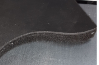

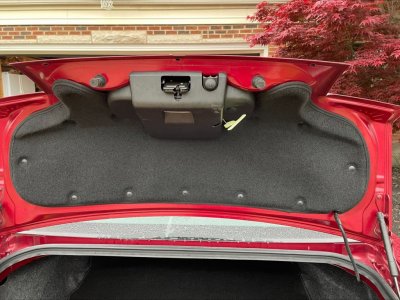

I live in the northern climbs and did have a bit of rust on the driver's side. Cleaned it out and fiberglassed that area and no issues since (5 years now). Regarding trunk kits there are several liners out there to choose from. Most look similar to this in design and quality. If I remember it ran around ~$100 or so....? All I added was some 10mm self-stick foam under it; and it does an impressive job of knocking down noise. Now, I have to get to the headliner some day but work and life always seem to have a laundry list of things that must be done first.
View attachment 87124 View attachment 87125
that’s exactly the liner I’m looking for. I have one on my eBay watchlist, but if you can remember where you bought this exact one let me know.
