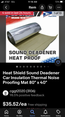

Any thoughts on this one…good/bad? Figure I may as well do this too while cars apart. Can get 62sqft (if math is correct) for $90! Figure I’ll do fender wells, floorboard, under rear seat, and trunk…think 62sqft will be enough?
It's similar to what I used. Only caution would be if you have/get leaks it'll hold water so I would only put it on top of a butyl product. That's the best combination to knock down noise and insulate the interior. Additionally, placing it down under carpet can make it tight when reassembling so ensure you account for any clearance issues; seat mountings, etc. Otherwise, yeah, 62 sq feet should cover interior foot wells, floorboards, rear seats and probably most of the trunk. Just be sure you do the sides and run it up to the base of the rear windows in the rear seats. Then go after the trunk. Also pay attention to rear wheel wells (interior); use butyl first and lay the mat down as a second layer. Avoid using that mat on anything external (i.e. exterior fender wells since it does hold water if it gets wet). Use the butyl on the fender wells if you're going to go that far.

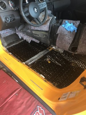

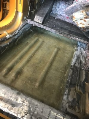

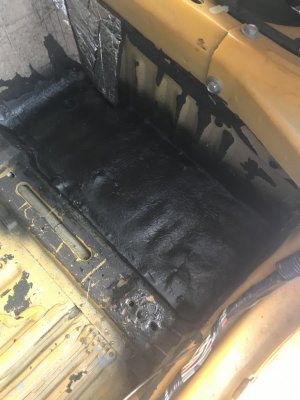

To take care of the floors in my son's '07 which was leaking and beginning to show signs of corrosion I simply removed everything and fiber glassed the floors. Guaranteed no worries; that fix will probably outlast the car. Then laid down butyl and the mat; works pretty good knocking down noise. Overkill? For sure but the quiet ride is luxurious.
Yeah, will sell the car before I ever try to take this stuff up.
3 layers Fiberglass matting drivers side
Fiberglass mat driver's rear floor area.
Butyl mat over fiberglass
