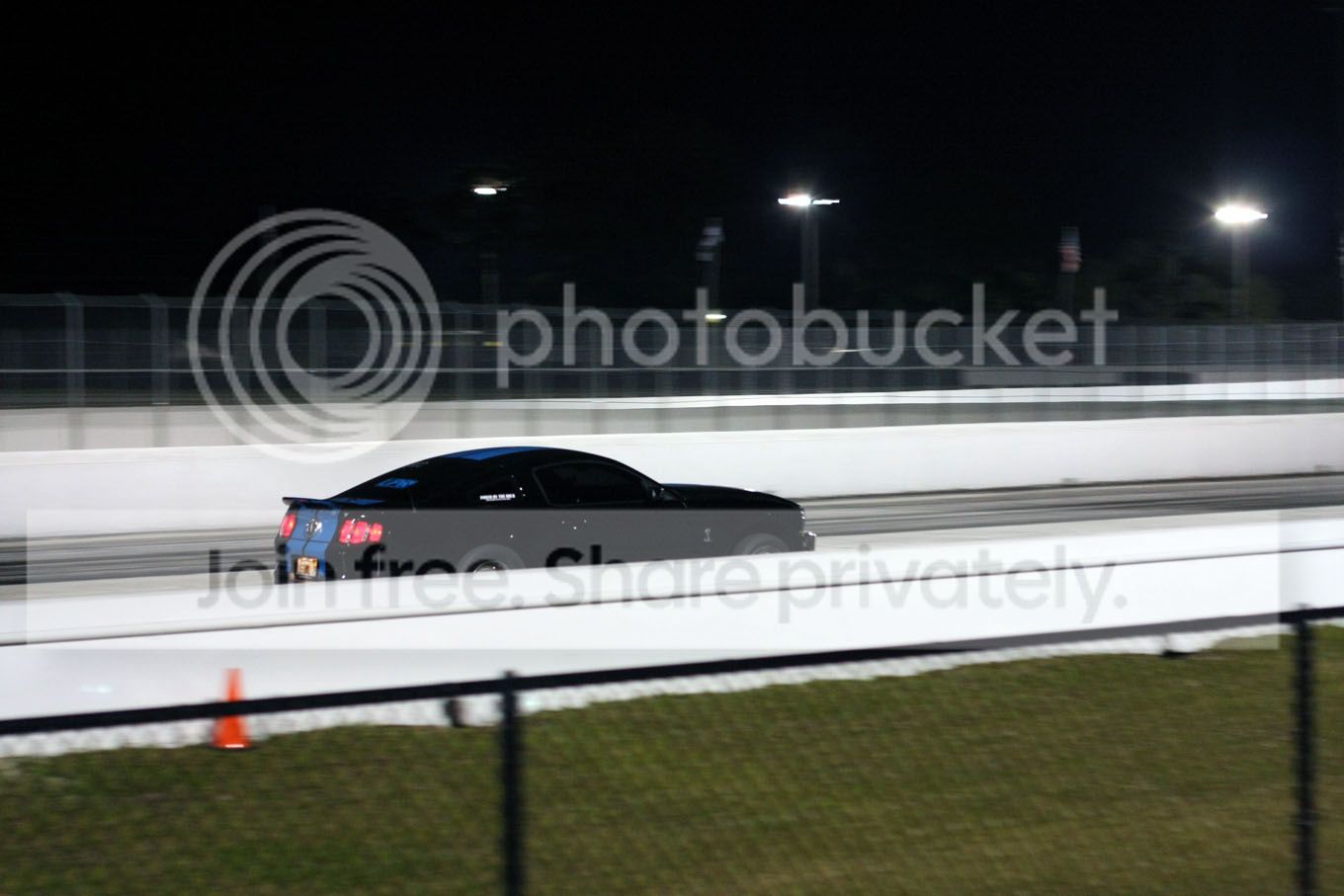

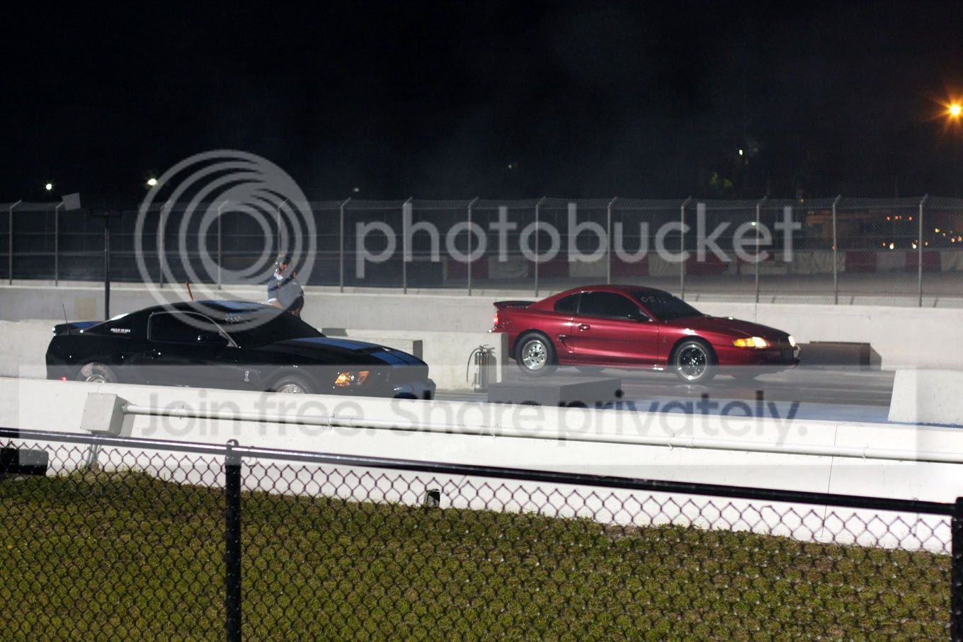

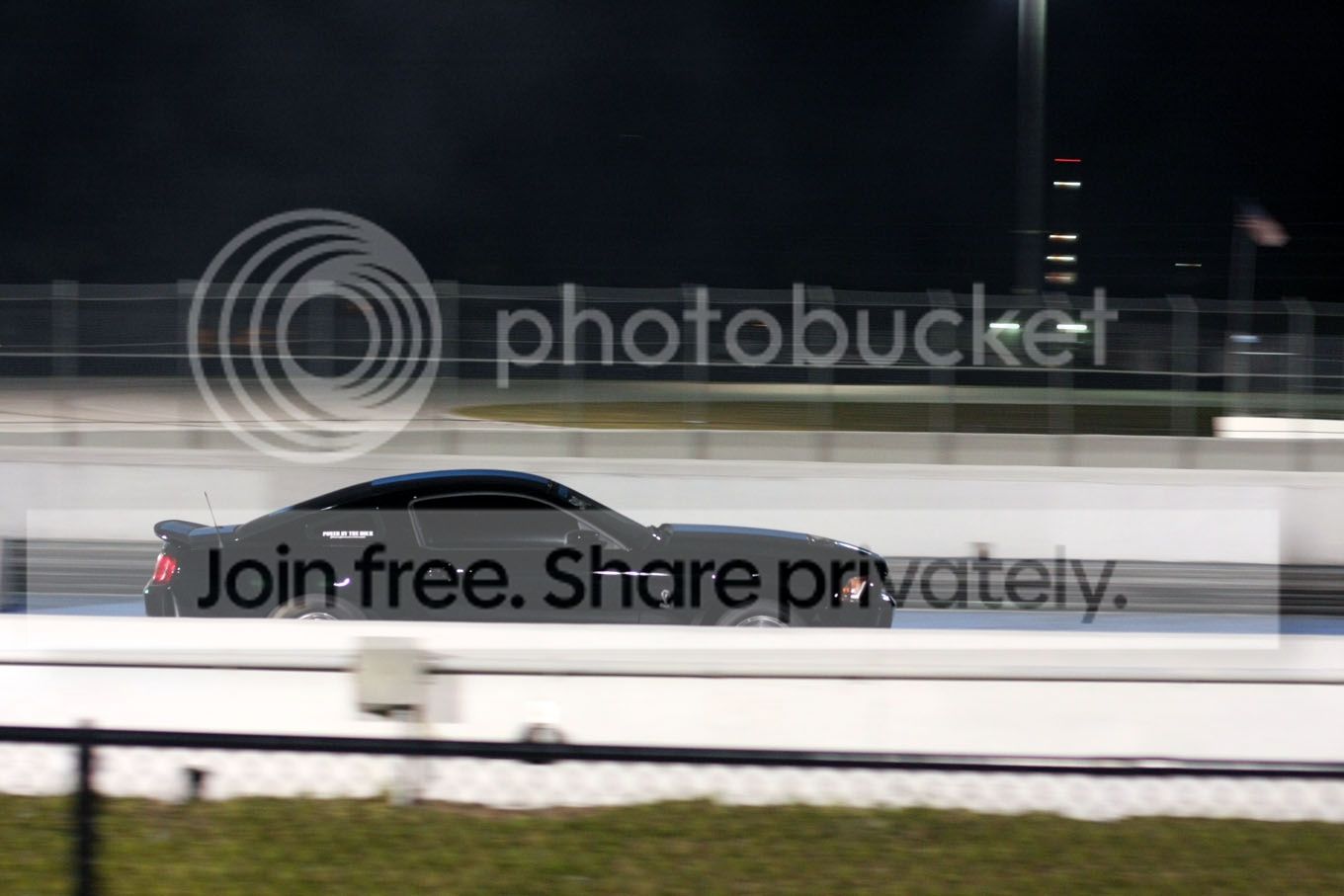

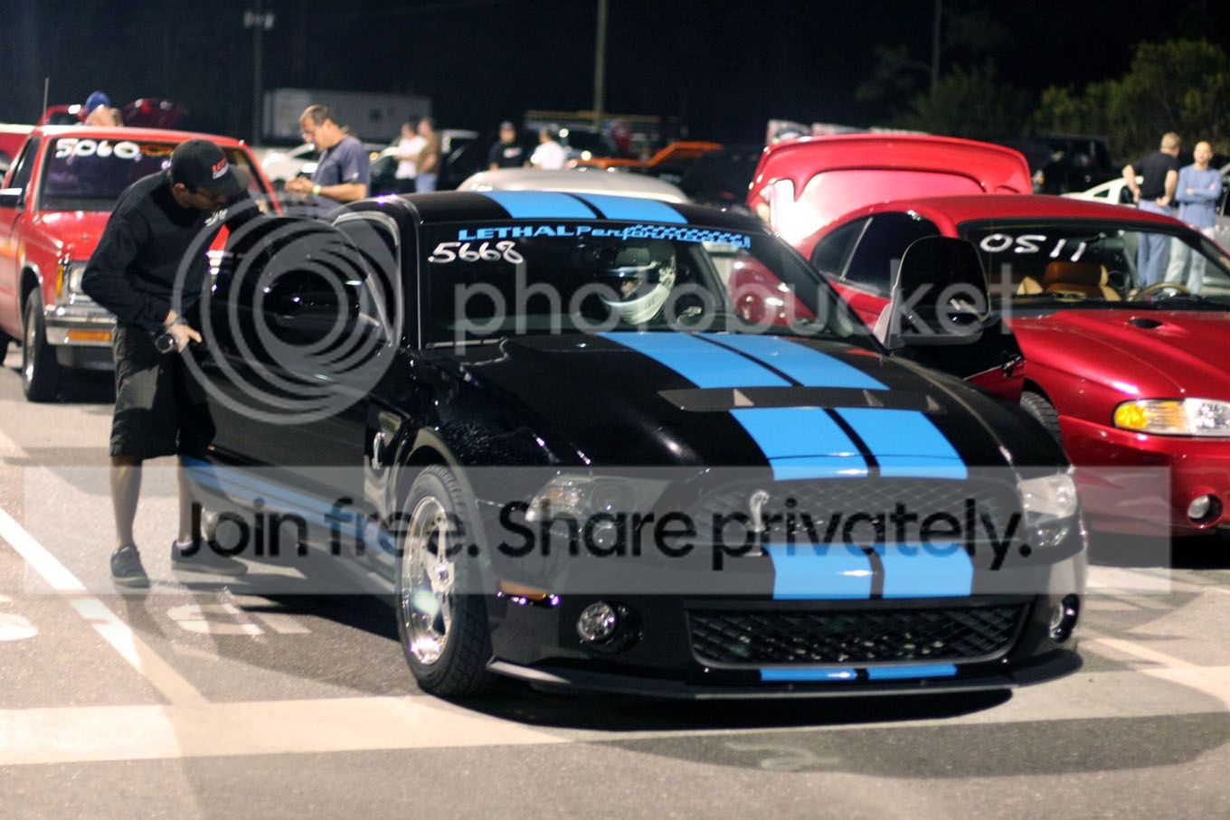

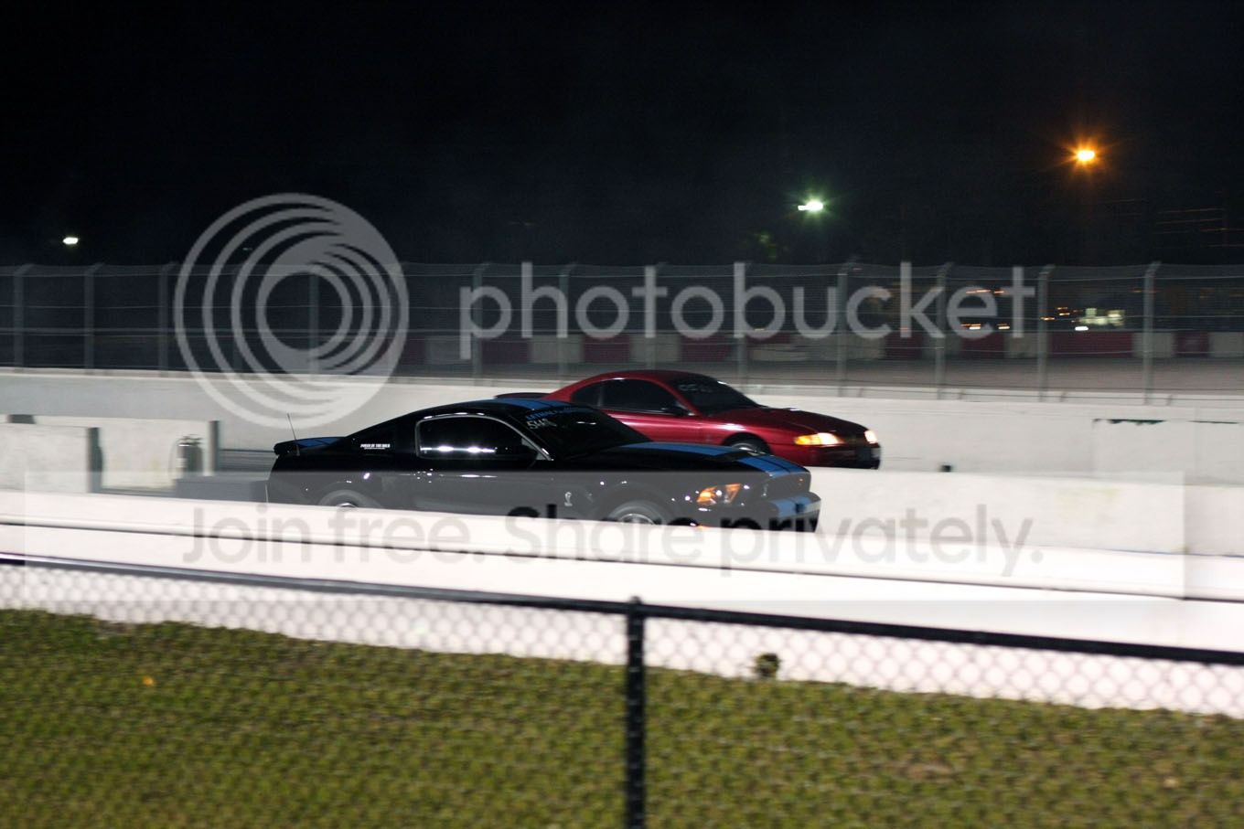

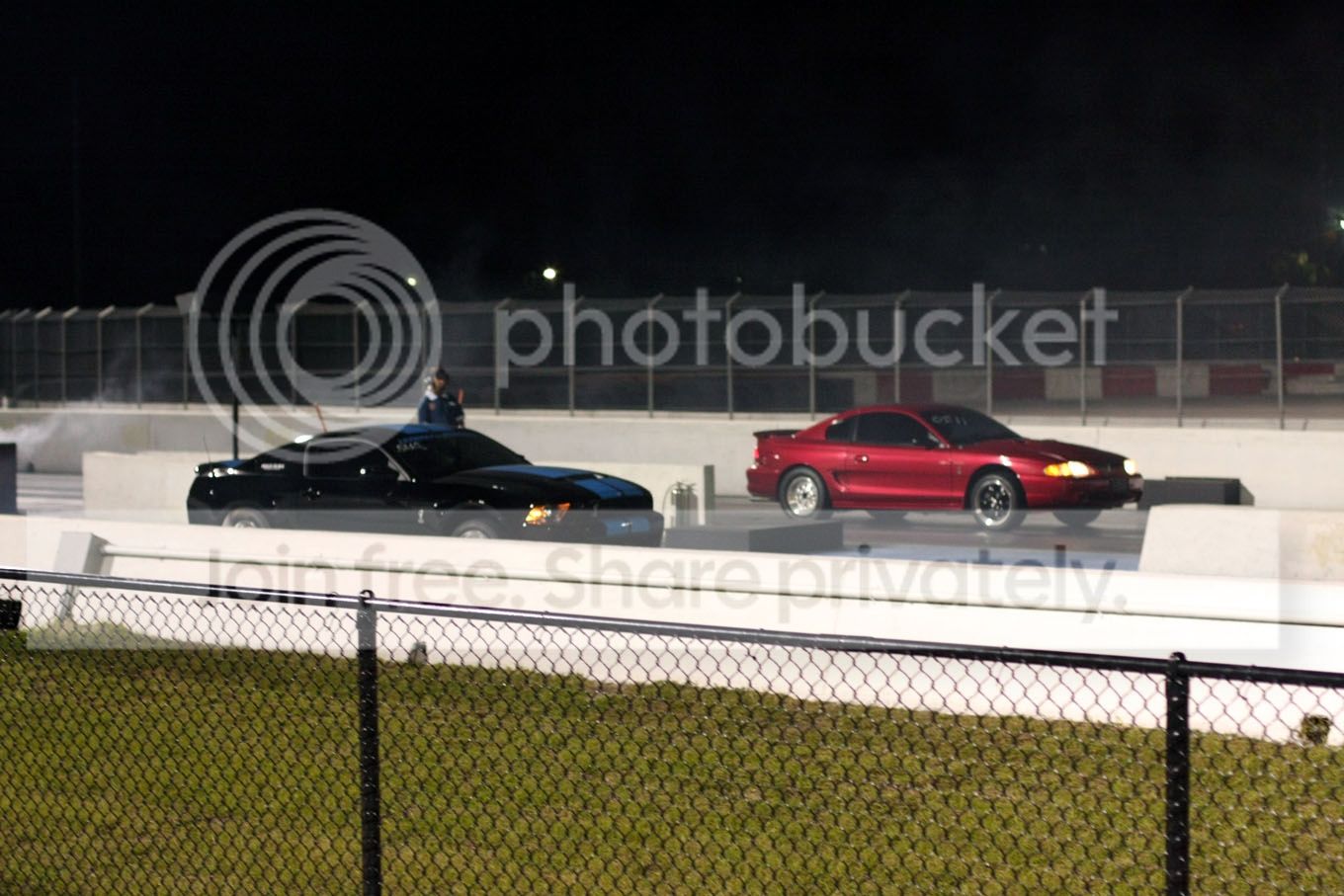

Photo's compliments of Steve Peddicord. Thanks Steve!
