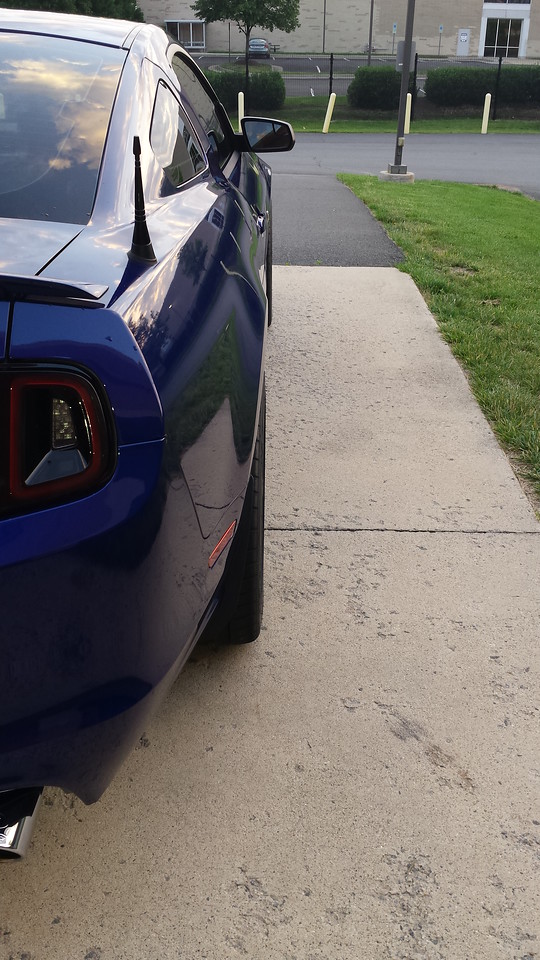

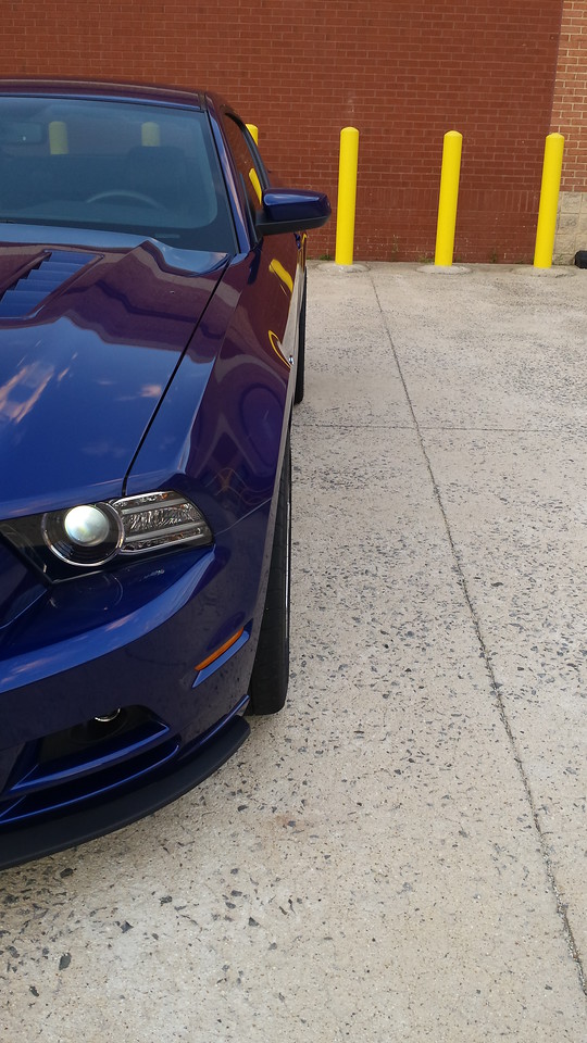

As Norm mentions, 20s are a compromise for several reasons.
Based on the driving style you've mentioned and power levels you're aiming for, I'd recommend 285/35s on 19x10 ET42 wheels for a square setup. Forgestar CF5V are similar to the Velgen VMB5 and available in a wider range of widths/offsets and colors. Bridgestone RE-71R is an exceptional tire in many aspects and available in 285/35s among other sizes.
Should you desire a staggered stance, up the rear to a 19x11 ET55 with 305/30s.
The above tire sizes are also available in the Nitto NT555G2 (street) and NT01 (track) lineup if you're married to the brand.
Here's a shot of my Mustang with 19x10 ET42 Forgestar CF5 and 285/35s in a square setup looking down the side. Nice flush fit and no poke.

It is overwhelming lol. My main thing was I didn’t want the rear to poke and my 20x11 50mm fit exactly flush with the top of the quarter panel.

I like the sound of a square setup. I figured a 285 35 19 would rub on the front when turning with my 1" drop. If not, that would definitely be the way to go.
My Mustang sits about 1.5" lower at the front and there is no rub going lock to lock with 285/35s on 19x10s
