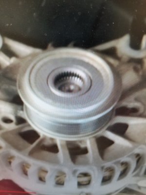

My alternator doesn't have a nut holding it on, It looks like a spire with 46 sides ,lol I'll post a picture tomorrow , Guys, thank you, I love this old car, dont want to damage it, ❤
What you're referring to is a spline tool. They can be purchased from any auto part stores, such as Advance Auto and O'Reilly stores.

Keith carter
Apr 13, 2019
12
UPDATE, pulled cold air off, pull radiator fan loosened water pump pulley, changed alternator bolts, put the water pump pulley on it will pot work, sent the wrong one, hit the block on the bottom side, so I put everything back together, and I don't know what to do with them now, boat anchor if I had a boat, then cranked the car and check engine light came on, the intake was leaking so pulled it off again and adjusted, then was ok, oh well could be worse

This is what it looks likeView attachment 69441
Keith, thank you for posting a picture of your alternator. As I mentioned yesterday, my Saleen S/C kit included an alternator pulley removal tool which is basically a socket with a multi-point star fitting that fits the alternator pulley. Using that socket with the impact gun, the pulley came right off. However, after reading over the installation problems you had thanks to Saleen sending you the wrong pulleys, I would follow Phil1098's advice and list the pulleys in the kit for sale or contact Saleen or whomever you purchased them from and find out if they'll provide you with a return authorization to send them back? I also agree with what Phil mentioned in his post that you would be much better off getting your underdrive pulley set from Steeda, this way you won't have to mess around with the alternator at all. In the meantime, we'll continue looking forward to your updates.
