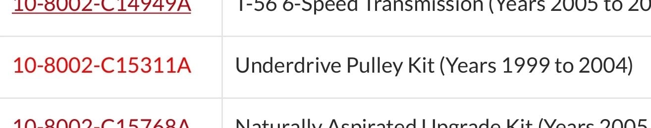

    You might have got a set for an older car. I believe in 2001 the water pump offset was different even though it was also a 4.6L. There was a "long" pump at 87mm , and a "short" pump at 65mm. I think 2001 to 2004 cars used the different pump.
    The install instructions for the underdrive pulleys for the 1999 to 2004 Saleen cars is located here:
    https://soec.org/literature/manuals/#
    NOTE the use of a spacer in the original kit. (Pic below)
    You can post them for sale on one of the Saleen forums and someone will probably snatch them up:
    https://saleenforums.soec.org/
