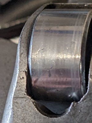

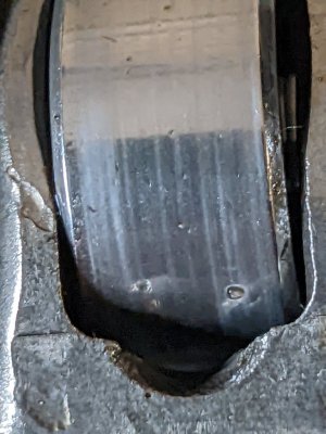

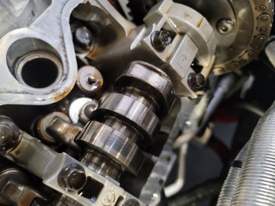

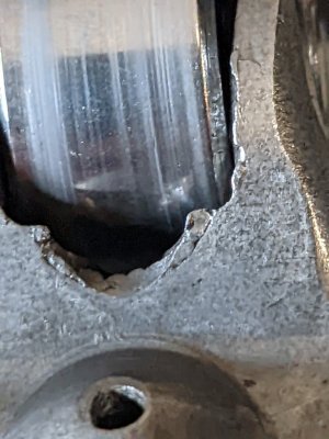

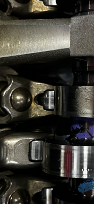

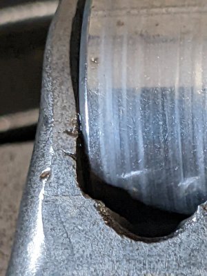

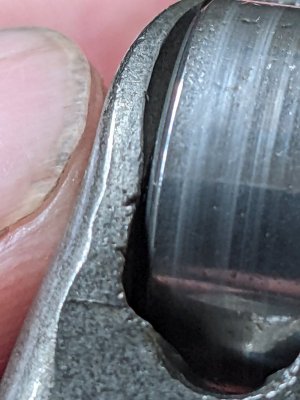

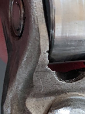

I've experienced catastrophic valve train failure due to failing cam follwers (rollers / arms); both driver and passenger side.
Has anyone else experienced this? Did you ever figure out the cause? My followers are failing in just a few thousand miles; less than 10K I believe. The rollers end up locking up...figuring the needle bearings are failing. I have found 6 followers in addition to the completely failed with rough rollers.
My valve train setup is Comp Cams 127450, PAC 3V Springs (Pac springs are 105 seat pressure @ 1.670 and the open pressure is 270lbs @ 1.120 says max lift of .550"), in Ford Racing CNC & Ported heads; my phasers are locked, VCT removed, and timing retarded 4 degrees.

Have you had a follower failure without a cam failure? The cam looks soft to me.
We have been experiencing that same problem, in the boat in my avatar, with big block Chevys. Our cause was soft cam cores.
Are you able to have a hardness test (Rockwell or Brinell) run on the cams, to rule that out as a possibility? Cam lobes are a bearing surface, and need to have a certain hardness. I would first try dragging a file across one of the good lobes. If the cam is soft, the file will be able to cut it. If the cam is hardened, the file will just slide across the surface and will not cut.
Comp can sometimes be helpful (sometimes not) in diagnosing the root cause.
Sometimes it is difficult to determine what happened first, unless you catch it when failure is just starting. To me, that doesn't look like an oil starvation failure or a roller failure. It looks like the rollers are pushing into the lobes. I also don't believe that it is from excessive spring pressure, based on the specs of your springs.
In your last picture, where the lobes contacted the follower body, but the follower is mostly in tact, do the rollers still turn without excessive play? I understand that after a failure like this, there will be debris in the bearings and I can see where the damaged follower body is in contact with the roller? Is there a flat spot on the rollers?
Yes, this has happened previously, but I caught it in time before cam damage occurred.
I have found numerous followers where the bearing roll rough and gritty.
I have previously and recently found rollers that have seized and were flat spotted due to the cam lobe.
So the initial failure mode are the followers, the roller bearings fail, leading to seized rollers, and if not caught early, the seized follower roller will eat into the cam over time.
Problem is with a motor making over 700HP, you don't notice these failures unless they are audible. I've been driving with two cylinders that only had two functioning valves.
I have not heard of getting cams checked for hardness. I personally feel the cam is not the failure mode as I have found seized follower rollers completely flat spotted with only surface damage to the cam lobe.
When the followers fail, the needle bearings start wearing, rollers start rolling gritty and rough until the bearings fail and the roller drops into the follower body seizing, then the cam lobe starts wearing into the roller until it eventually starts wearing into the follower body.
....from my observations...

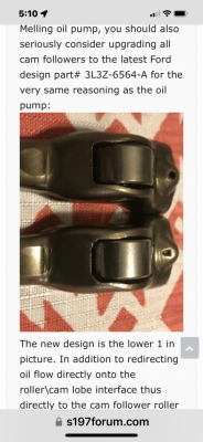

The 2009 and 2010 F150's have a rep for the roller followers breaking on stock motors and it seems like the stock replacement ones were just as bad until they revised the design to the smaller oil hole that directs the oil towards the cam lobe.
I will be trying the revised ones when my motor goes back together-I haven't had a failure but if the internet is to be believed, my stockers are a ticking time bomb. Maybe that extra oil directed to the cam lobe keeps the follower bearings alive, it's pretty plausible.
I did read that. And I was wondering why the F150 3V had that issue and not the Mustang 3Vs... What is the difference in valve train?
The new followers I just picked up from Ford do have a much smaller hole!!
The original OEM followers from my stock engine had much larger holes, I believe they even had some followers without holes on earlier model year. But when I built my current motor, the followers had a slightly smaller hole from my OEM ones. And these new ones I just picked up, the hole is even smaller.

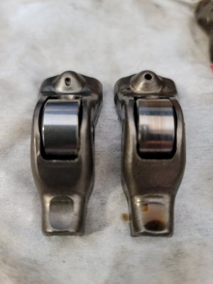

863DEFED-F3F4-4E96-B9FC-5E6B242395B0.png Here is close up of the original followers in my 05 that was recently rebuilt. One of the followers was starting to show wear and was on the verge of damaging the cam. It looks like the ones the OP posted.
There is really no difference in Valvetrain between the 5.4 and the 4.6 so it could have been as simple as how they allotted the shipments of the roller followers. Maybe the 5.4 and 4.6 were assembled in different plants and the lower production mustang motors were built with the leftover followers that didn't fail on a regular basis from previous years.
This is just a theory.

Maybe my info is bad, but I thought the latest Motorcraft rockers and followers had larger oil passages? I just had to go into a 5.4 in my F350 last winter and my (Ford certified 30 year expert ) mechanic recommended I replace the rockers and followers just to try and increase oil flow/pressure. He said the latest version had larger holes for more oil to the rollers. I bought the kit as well as the high output oil pump from Melling. Truck is running great.
Laga
Aug 10, 2019
998
521
Chicago
These are what you are referring to I believe. We used them on my build, along with the billet oil pump.047140AB-45CC-48D1-B2E9-A04BD236B64E.pngfrom this thread. https://www.s197forum.com/threads/melling-m340hv-oil-pump-thoughts.139957/

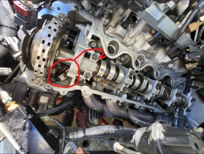

I re-read the thread about the Melling 340 oil pump and due to the pictures that @GlassTop09 had posted, I went and inspected my stock roller followers. 4 of them had similar-or worse defects in the thin part of the body between the roller and the lash adjusters and 3 of them had smaller defects. It's like the metallurgy and QC took a big dump in the later years of production. A lot of these look like the perfect place for a crack to start.
PXL_20220801_212515622.MP.jpg PXL_20220801_212559580.MP.jpg PXL_20220801_212702514.MP.jpg PXL_20220801_212800094.MP.jpg PXL_20220801_212910309.MP.jpg PXL_20220801_212838768.MP.jpg

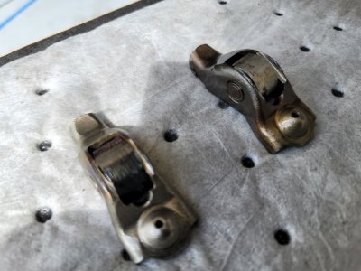

I had a follower fail on an intake valve on cylinder #4 last year.
Pretty sure it was caused by POS Boundary OPG's causing a loss of oil pressure.
I had finished an 1/8 mile pass and noticed zero oil pressure on my gauge and the low oil pressure idiot light was lit.
I loaded the car back on the trailer and let it sit over night, next morning fired it up to move it into the garage and heard a rattle as fired up and then seizure as the valve dropped.
I think I'll put it back together this fall and see if I can get it into the 9's.

How did the oil pump gears drop a valve?
"POS Boundary OPG's caused a loss of oil pressure" .. caused needle bearings to fail, roller bearing pin also broke and the carcass got caught between the follower and valve spring causing valve spring to hang dislodging the valve spring keepers, Lack of valve spring retention caused valve to remain extended into combustion chamber and corresponding impact with piston.
