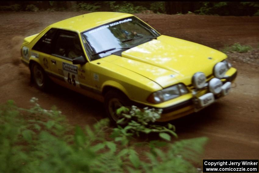

I can tell you, as a spectator, nothing...NOTHING...sounds like an angry Mustang roaring through the woods unseen but getting louder and louder until the car rips around a blind corner, rips up the dirt road kicks the tail out, throws rocks and dirt all over the place, kicking up dust and drifts around the corner as it pulls gear after gear up and over the hump and disappears back into the woods with the sweet sweet sound of that angry 5.0 echoing off all the trees.
This experience was real. It happened in the PA woods during the Susquehanna Trail Pro Rally in the late 90's. The car was 5.0 LX hatchback. Bight yellow. Small cowl induction hood. Pushrod 302. Cool ass car.
I took a chance and googled the car I watched race. Shit. I found pics.
