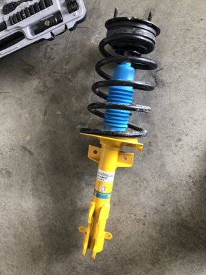

FC0207A2-DA5D-4EF7-B8C6-4D45C8A4B783.jpeg F73FDFC3-D53B-43DB-A99C-A55548701E0D.jpeg Update. Got the suspension fully put all the suspension bits together. Gt500 top mounts, gt500 springs (shoutout to bl817) and the Bilsteins all bolted right up. Removed the rear sway bar because the bushing were so worn the bar was useless. So I’ll be running no sways front and rear. Looks like I got about 29-1/2in and 29in of Droop Front and rear. Curious if what Travel amount it has.
Next step I’m just waiting on those plastic clips to come in to mount the wheel well liners, fix a side skirt, mount it all up, then fabricate a skid plate. After that I’m going to try to get some cheap 16in wheels and try to fit them, maybe I’ll have to throw those V6 Calipers on front

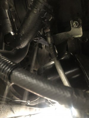

Threw the fender splash guards in today and figured to start the car and let her idle since the fuel has been sitting for awhile. After about 30 minutes of idle the car started pouring water from what looked like above the power steering pump. Looked at all the lines and I don’t see any rips or tears. No idea what caused it but as soon as it cooled off it stopped pouring. Hmmm

Pinhole leak in a hose that only drips when the system is under pressure. Since there's no coolant in it now, do yourself a favor and just replace ALL the hoses.

That’s actually a really good precaution. I’ll do that for sure.
Currently filled it back up, checked the fan fuses, let it run to make sure the fan was still working. So far the car has been running longer then previously and the thermostat has cycled about 5 times. Not a drop. I’m super confused

I lied got it to leak again. Has to be the hose above the power steering pump
