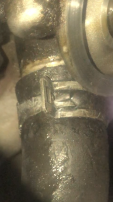

51617C7C-6B0B-4D56-B799-78150E38C349.png Got my mishimoto rad hoses in and I’m taking today to put them on. On the lower hose that goes to the block there’s one clip that only has one ear on it to put an pair of pliers on and it’s driving me nuts. Does this clamp need a special tool or something?

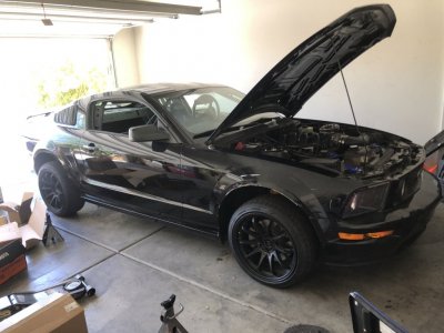

84C9C962-8B9D-49F7-B797-B8DA058A6B6C.jpeg Well cars all back together! Drove it around a bit and it feels great! The suspension is of course much softer than the other springs I had but the ride height should work a lot better.
Next step is to build a skid plate. My plan is to take the car up to my dads house who has a lift and a welder to see what we can do. Anyone have any suggestions or recommendations of how to do this?

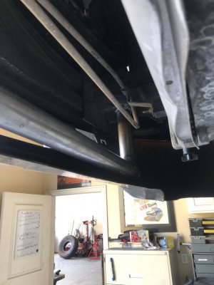

3C93E251-7755-4754-A9C5-80A534A5F23F.jpeg Today just finished up a draft of the skid plate. Welded a bar that goes in the bumpers skin thats going to have some tabs on it and then make a plate that’s going to run past the oil pan. After it’s done tomorrow it’ll be test time later this week

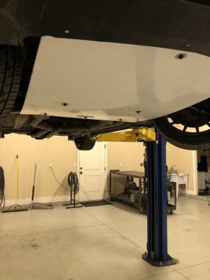

6816DDD6-7808-4D1B-BE26-F8E61A79F5E6.jpeg All welded up and bolted! Decided to use UHMWP plastic since king of the hammer rock crawler guys like to run it because it’s hard like a metal plate but rocks slide across it and don’t get caught.

View attachment 70072 All welded up and bolted! Decided to use UHMWP plastic since king of the hammer rock crawler guys like to run it because it’s hard like a metal plate but rocks slide across it and don’t get caught.
If you haven’t already done so - a piece of soft closed-cell foam glued between the plate and motor helps exclude rocks and debris.
Any “smashes” to the plate then are more-easily absorbed without stray stone “teeth” biting into thin oil pans and other fragile items.
Costs almost nothing in weight penalty, if stuck-down to the plate no hunting for it in Service, or forgetting it when bolting up the plate.
Not my idea - just passing it along from Rally Team friends.

That’s a good idea. Is the soft cell foam the same foam that’s used in fuel cells or is it something else?
