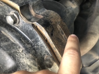

Small update. Finally got a chance to get my hands on the car, mostly looked over the rear end. I extended the rear upper arm a bit since I raised the car, pinion should be at a better angle.
One thing I’ve been confused about though, where the I put a angle finder to measure?? On the flat part of the axle housing?? Here’s some pics where I’m pointing where to I think I should measure.
everything else in the car looks good, rear upper control arm bushing is basically gone to I ordered a new one. Hopefully get it all figured out, then some tires, and another test day

Here’s the pics, I’m pointing at where I think the angle finder goes on the pumpkin, am I right?
