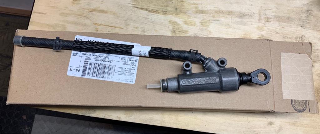

Alright I got 1 on the way!
Went w\ Tasca Ford using the link that JeremyH provided as they clearly show the newer part #DR3Z-7A543-A is the same part as part #DR3Z-7A543-AA & was 1 of the best on price that I found as well. Thanks again for posting the link, JeremyH!
I never got any feedback from GaudinAutoParts eBay store (....in their defense they stated in description that they only had 1 left in inventory so it could have sold already so no reason to respond...their price was in line w\ Tasca's but would've been nice to have gotten a response stating that they were out) & the other eBay store (Euro Auto Solutions) kinda gave a half-hearted response even though I sent them the picture of this MC w\ the part# clearly displayed on it to help w\ verification as they didn't list a picture of the product...so I walked (their asking price was $138.95 + tax so it wasn't too hard to walk anyway when I knew there was 1 potentially available for less).
Used PayPal so all the shipping info would be provided up front as well. Looks like it'll be shipped USPS so I'll assume a delivery time of the end of this week.
Gonna be looking forward to getting this puppy installed to see how she performs! Really love the fact that it's a genuine FoMoCo all aluminum part....didn't think Ford made 1 out of metal as all I saw listed on Ford.Parts.com were the plastic ones...even for the 13-14 GT500 as the only part # shown on Ford.Parts.com was the 7A543 suffix w\ the same picture drawing so was surprised when ghunt said that this part was metal....and got very excited when I saw the picture of the actual part so I had to snag 1 while the getting was good as these S197's are getting close to the Ford limit of 10 yrs parts inventory post manufacture (to cover any warranty repairs then % based on the number of sold units....mine is already there) & it gets worse for any special limited run vehicles such as this 13-14 GT500 (or my '09 Glass Roof Edition if looking for parts for the factory glass roof like the sunshade assembly as Ford.Parts.com shows it as discontinued & no aftermarket replicas exist but I was blessed to find a NIB genuine FoMoCo color matching replacement assembly on eBay after a yr of searching & am already having to wait on delivery of my FoMoCo EVAP replacement system that was ordered on 2-6-20, now due to lack of availability....back ordered).
Sorry for rambling & hijacking...…. Still am interested as to how the clutch operation came out w\ just 1 3\8" shim installed to bring the TOB preload to 5\8".....

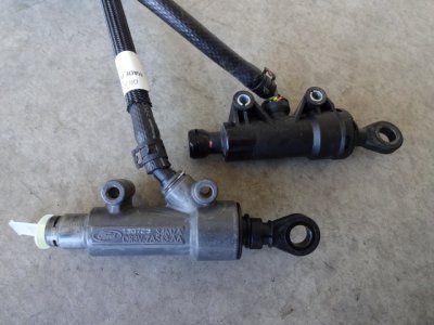

The picture that comes up on Tasca looks plastic to me, am I missing something?
Andrew, "Raredesign " bought the 13/14 GT500 unit and the billet end separately. He had such a hard time removing the original plastic end because it was on so well, that he ended up purchasing a second 13/14 unit and decided against the billet end replacement.

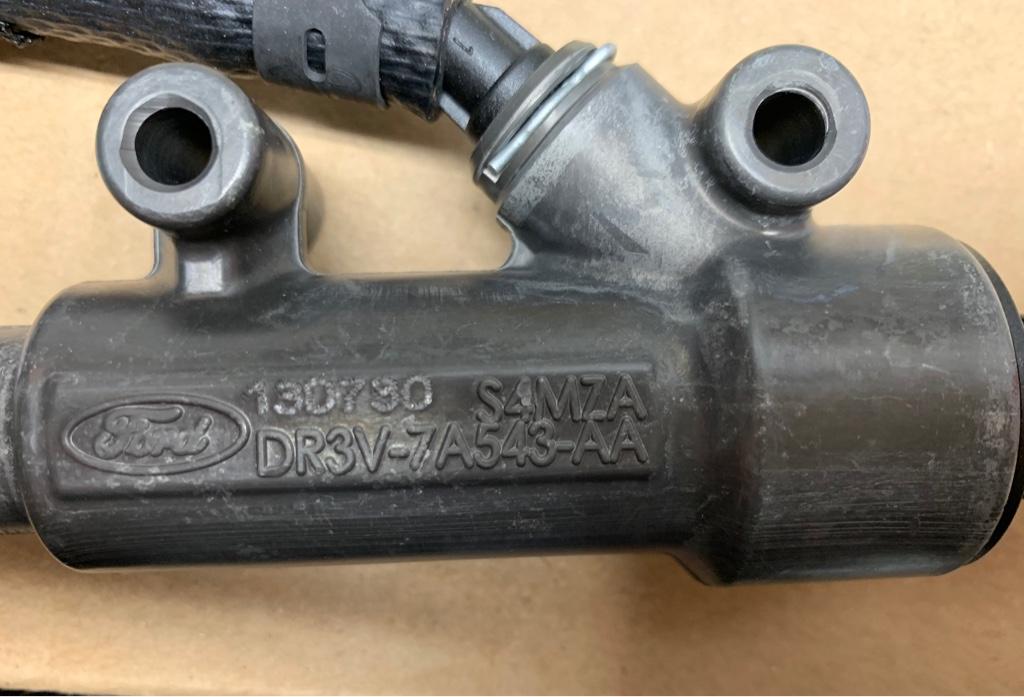

There are 3 visual design features that distinguish the metal 13-14 GT500 MC from the OEM plastic versions:
1.) The 2 mounting holes. All plastic versions have a roll pin insert installed in the 2 mounting holes to prevent damage to housing from overtorquing bolts. If you don't see these roll pin inserts at the 2 mounting holes it is due to the body being made of metal (aluminum in this case....all cast aluminum isn't shiny & bright). If you look at the pictures of this MC thru the 2 links provided you'll see what I'm talking bout.....
2.) The reservoir fluid hose attachment point. All the plastic OEM units have this port located in the center of the body between the 2 mounting holes whereas the 13-14 GT500 MC has this port attaching closer to the mounting hole closest to the pedal connecting shaft....this allows more fluid movement (displacement) per the same stroke length to move the TOB\slave cylinder further (approx. 3\16"-1\4" further travel than the plastic OEM MC).
3.) The actual FoMoCo part # is cast into the metal side of MC body of the 13-14 GT500 MC, the plastic OEM's do not have this.
Your confusing body with eyelet. Gt plastic body, gt500 metal body that is one of main upgrades. Both have plastic eyelets, albeit the gt500 one appears to be more robust.
The metal eyelit is a band aid for the Gt mc. The gt mc is weaker and suffers from body flex and rod distortion which leads do the eyelit failure over time as it takes more pedal force.
The gt500 mc with larger displacement and metal body does not have this issue. So no metal eyelet is needed.
To summarise, metal eyelet is a solution to a symptom of the poorly designed gt mc.
Gt500 mc fixes the root problem with a better engineered mc.

Got an email from Tasca Ford this morning stating that the order I sent in for this 13-14 GT500 MC part# DR3V-7A543-A has been placed on special order status so will be delayed for approx another 3-5 days or more before being able to fill my order & ship it out.
Not an issue for me as I am fully prepared to wait it out if this did happen as I knew these 13-14 GT500's have been out of production for >5 yrs, were a limited run so not a lot were produced & all of them are past the manuf warranty period so Ford part inventories for this particular part are gonna start drying up...………...

Update:
Got email from Tasca yesterday that unit has been shipped so it's coming now...………….
PS--My local Ford dealership don't keep these in stock due to it being a special item & Tasca's online store price is cheaper than the book price off Ford.com (usually what the dealerships use) so depending on the part being looked at it might be cheaper to get it thru a dealership's online\eBay store than at the dealership itself (don't mark up the price to cover inventory space costs due to the part being shipped directly from the regional warehouse). Sometimes it is, sometimes it isn't.
