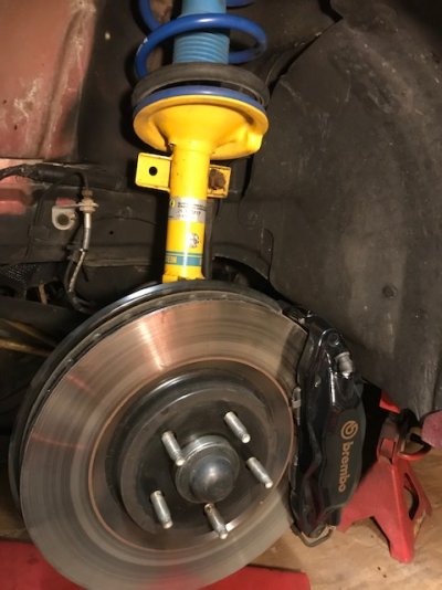

The four piston Brembos is a good upgrade and you will notice an improvement over stock. Not every rim clears the 4 piston calipers, so you need to check this.
I'm using the Brembos with the G-Loc R6 brake pads and have noticed a significant improvement. The R6 brake pads do make a little noise, but they do make other ones for street performance.
I don't see any benefits of going to 6 piston unless it's setup primarily for road racing. There aren't many rims that clear the 6 piston calipers.

Thanks for the input on the brake pads you were using. I was thinking that the 4P Brembo calipers had to be an improvement over the stock two pistons, or else Ford wouldn’t have used them on the GT500.
I just recently purchased a set of 19 inch wheels just for the purpose of upgrading to the larger rotor/caliper. It also just so happens that they will clear the 6P Brembo but I realize that on the street they are more for eye candy than performance benefits.
I will look into the street version of those pads that you mentioned. I hope to get some other recommendations on pads that work well on the streets, but also won’t eat the rotor to pieces.

The 4 piston Brembo kit that I purchased came with the calipers, rotors, brake pads and brake lines. Seemed like quality rotors and the brake pads were fine for the street. Under hard braking while autocrossing the G-Loc brake pads were noticeably better than what came with the kit.
Not sure there's improved performance with slotted or crossed drilled rotors on the S197, so staying with the blanks is a good way to save money. Most of the folks that I know that do track days/road race their S197 just us a high quality blank. I'm still using the same rotors that came with the kit and they're performing great.
As Silver says they're a good upgrade (I use them myself) and they didn't cost much. Just go to most any auto parts store and ask for reman 08 GT500 4P Brembo calipers. Think I paid $125 ea side (without a core) and another $200 for new rotors/brake pads. All in all about $450 out the door. Upgrade your brake lines to steel braided at the same time. You can order everything from O'Reilly's. That was 3-4 yrs ago so likely higher now but they came powder coated in gloss black and made a significant difference in braking distances (saved me once actually). I also bought the stock Ford 19" rims (2014 I believe) that fit the Brembo's so I don't have to use spacers but I have them for other rims I have. Totally worth it IMHO and one of the best investments I've made on the car.
