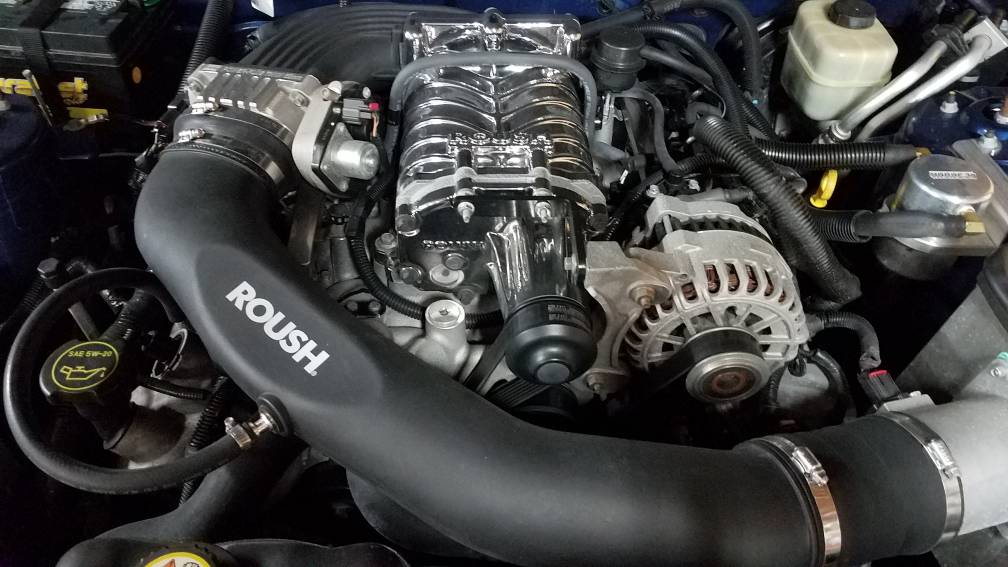

You might be able to piece together a used eaton m90 supercharger setup for that budget or a few bucks more. They are out of vogue but still solid performers.

Thanks! I assumed that would be way out of my reach.

I think I saw an M90 system going for 1500.
I had one for a few years, it was fantastic. The car turns into what it always should have been. Tires on fire. Nice whining noise if you find someone selling a used 2.49 pulley system/cai for peanuts. (I have one kicking around. Nobody wants it.)
Just save your money and enjoy the car. Pick bottles for a while. Gears/etc... won't make enough of a difference.
