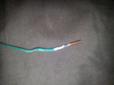

Blurry pic this is a pin I pulled yesterday out of the only harness i could find. My car was built in 02/07 will it work or do I need a tach adapter. A buddy of mine gave me a msd ignition pick up. Part no. 8919. But I couldn't get it to work as a temp solution. Until I got my pcm re pinned or a tach adapter. I am praying I can re pin it as I don't like cutting wires.

Can't really tell anything from the picture, but if it was my car I would go ahead and insert the pin into the harness/connector and check the output on my tac. Myself, I'm using it to run both my Raptor and Turbomart Boost Controller without a problem.

It's a round pin I tried to find a square pin but no luck. Everyone pretty much snatches the harness and ecu's up ASAP. I am extremely nervous when it comes to wiring. I can deal with hard parts all day long. As that's what I do at work but on cats. Marine diesel engines are not as complicated though.

Same problem I had, but I squared with a pair of needle nose pliers and patience. If you're not comfortable, I would find someone in your area who is. I work electronics, powertrain, and airframe extensively, so my comfort level is pretty high when it comes to things like this.
