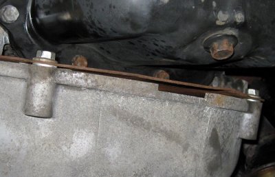

2) separator plate rattle between the engine and bell housing. I loosened two lower bolts and placed washers between plate and pried the plate to create clearance between it and flywheel that is adjacent to the plate ... fixed.Sep Plate Rattle Fix 6 - Copy.jpg
