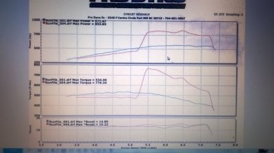

Never heard of Todd Warren, but I did get a set up L&M custom cams for my build, Main reason was I wanted a more phaser friendly cam designed to use limiters.
Mike's profile picked up 25hp over the Comp 127300's I was using and they hold power out to 7800rpm. Limited I made 598rwhp on pump 93, I ended up locking them and dropped to 570.
I don't have the 7800 dyno sheet but this one is to 7300 ... Cams are locked ..
To keep it simple,, No you don't need a custom grind but if I had it to do over again,, I'd get a custom profile cut to be locked out and save youself the headache of tearing back into it when the phaser fails,, and they will ...
