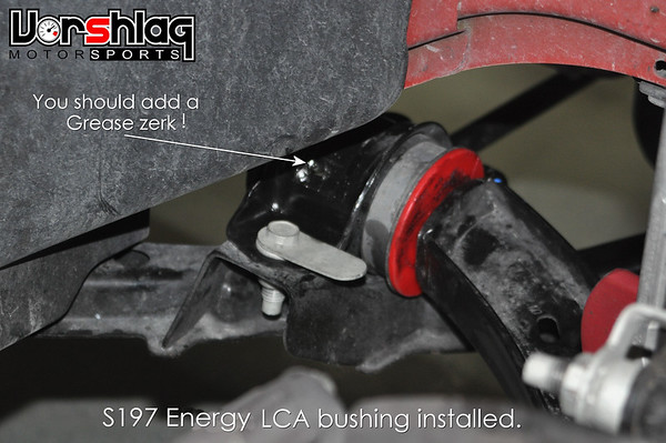

Great pics, and yea... that looks like a bushing that was made wrong. Energy Suspensions isn't the worlds best brand, but they do make a lot of offerings and generally speaking they work well. That seems like a bit of a fluke - sorry you experienced that. We sell Energy... and Powerflex... and Whiteline... and other brands of polyurethane / non-rubber elastomer bushings and I feel they ARE appropriate for many dual purpose and even purpose built track and autocross cars. Let me make my case....

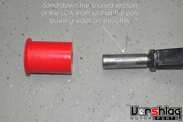

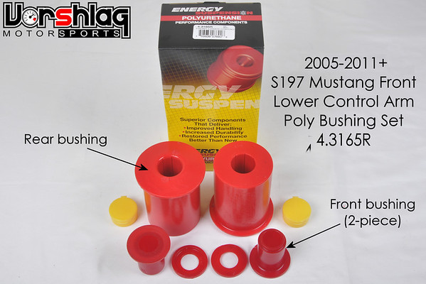

The Energy Kit for the S197 front LCA is pretty basic. The rearmost bushings are the MOST important ones to replace. Many times we leave the front bushings alone, but if they are made right, installed right, and greased they should last a decade or more. I'm not saying that "ddd4114" did anything wrong here - those do look like they weren't made correctly. Greasing those wouldn't have likely made a difference, but long term use without grease zerks can and will kill a poly bushing.
We show picture this in our instructions for the S197 Energy Bushings but not everyone reads them - the knurled finish on the LCA part that inserts into the bushings needs to be sanded smooth, otherwise it will chew up the poly bushings as shown above. This is present on the stock control arms for the rearmost front LCA bushing.
Adding a grease zerk to ANY poly bushing is muey importante! I cannot overstress this point. :)
There is never a polyurethane bushing we install at my shop that does NOT get a grease zerk. I just don't give the customer the option to "opt out"....
Corvette, Miata, Mustang - don't care. If it is a bushing that pivots (in ONE axis) and is made of "not rubber", it gets a grease zerk or it doesn't get installed. We've seen non-greased poly bushings last less than ONE YEAR... so its just become policy here. ZERK THEM ALL. #PolyLivesMatter

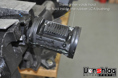

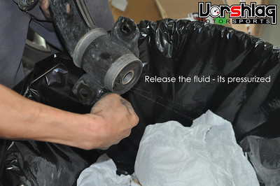

With a stock S197 with the massive rubber/fluid filled front LCA bushing installed, do this.... have a buddy drive the car while you stand nearby. Have them accelerate to about 20 mph than stomp on the brakes. It helps if you stand where the car will come to rest. WATCH the wheel squirm fore-aft (wheelbase change) and in/out (toe change) as it comes to a stop. It doesn't take much braking effort or speed to SEE this happen. I've done this with lots of folks and its pretty eye opening (I need to make a video). That toe change only gets worse as brake pad friction and mechanical tire grip goes up. It changes the turn in feel, tire wear, braking stability and more. I've driven so many of these cars with and without poly bushings I can always tell the difference just by driving them hard.... I can feel the wheel flopping around with the stock rubber bits.
Poly bushings remove that flex and slop that the OEM rubber bushings have - the rearmost bushing on the front control arm makes the biggest difference here. Its the size of a beer can and filled with goo. "Goo" is not a good suspension material. :insane:

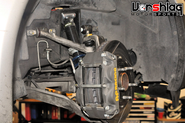

Before Energy Front Bushings:
After:
Watch the ball joint to see the difference in deflection under braking.
