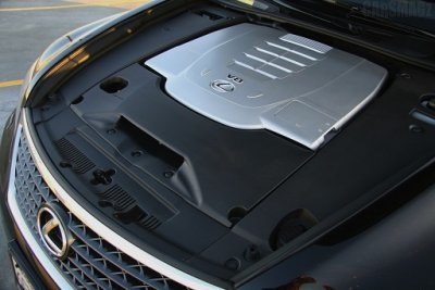

Speaking of engines, it can't be good for heat control to have all of that plastic shrouding on new cars today. I mean damn, you pop the hood on any new car and all you see is plastic covers everywhere. Here's the xtreme version below. Damn Lexus, chill out a bit!

I don’t think it really matters because even if the engine cover wasn’t there the hood would be.
