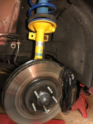

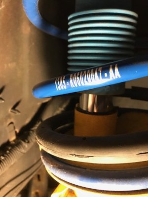

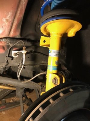

I'm running B6 Bilstein struts/shocks. They're great; no issues there. I'm also running all urethane everywhere I can and NVH is not a problem as long as all joints are well greased and tight. In my experience it's when a urethane (or any) joint is loose that you end up w/NVH. I would try changing out the springs and see if that doesn't make for a better ride.
In my case it was the springs that really made a huge difference. I also did a lot to my car stiffening it up with frame connectors; lower frame braces and whatnot. If you're interested in what I added let me know and I'll forward you a list.
Here's the numbers off of the Roush springs: 1305-R05020047-AA Front & Rears retail for ~$260 - 280. I think I paid $250 a couple of years ago.

Roush front springs will lower the front end by 1/2". Roush rear springs will lower the rear end by at least 1". Roush springs are 20% stiffer than oem.
