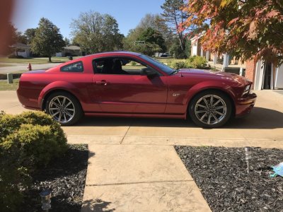

I understand what you're say'in.....Still using B6/Roush springs. Never had a problem with lowered operations. As I said for me it's been the best comfort/handling set up that I can find and I've tried at least three different combinations to find the right balance. I don't track my car but I do high speed runs now and then through the mountains and wanted a combination that would handle well and be comfortable over a 6 - 8 hr drive. I've also improved the overall handling of the car (at least in my mind) by adding Brembo brakes, aftermarket sway bars, links, strut braces, front lower frame braces, frame connectors; a few gauges and a few gimmicks like ambient lighting/LED's and what not along with sound deadening and just about everything else you could do to one of these cars sans a Watts/Link and Torque arm (which I may try just to see if they make a difference). Each item that's still on the car I've kept for a reason. Some will argue they're unnecessary (like superchargers); truth be known everyone is entitled to their own opinion. I like my setup and I think most people will agree.
As far as pre-tension of the shock goes at full height I have no issues with the springs being too short so I've never worried about a safety issue. If someone is I suggest tying down the spring to the base of the shock with a couple of heavy duty plastic ties (applies to front struts only). As noted the Roush springs are shorter than stock but not by much. Enjoy.

IMHO! Knowing the Roush springs lower both the front and rear suspension by just 1/2" over "OEM" My guess is you shouldn't run across any issues as far as the springs being too short for the B6 dampers, even when the shock/strut goes to full height. Nevertheless, despite the Roush springs being shorter than "OEM" stock, just as you noted, it's not by very much at all to be concerned about :waytogo:
